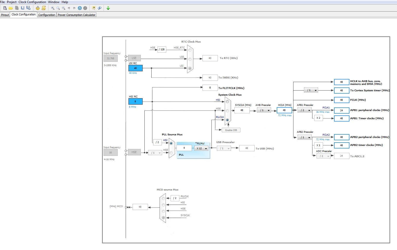

Hello, trying to generate 1 millisecond interrupt using TIM4 timer with in STM32F103 series of processor. By selectinghtim4.Init.Period = 1 able to generate Two millisecond interrupt. When we configurehtim4.Init.Period = 0, not able to get any interrupt.

Attached Clock configuration mxcube application in jpeg format.

The values programmed as N-1
The value in prescaler should generally be the smaller of the two terms.
The Period=0 turns OFF the timer, it has nowhere to count
For 1ms from a 36 MHz source
Prescaler = 0
Period =  36000 - 1
For 1ms from a 48 MHz source
Prescaler = 0
Period =  48000 - 1
or more nominally
Prescaler = 0;
Period = (TIMCLK / 1000) - 1; // 1 KHz (1ms)
