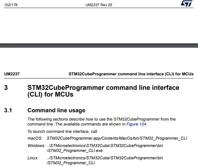

We are using STM32CubeProgrammer and STLINK-V3SET to program our products on our assembly line for mass production.
We have a couple of questions
1) Is there a way to program using the command line or some other mechanism to keep a record of the number of devices programmed successfully or failed to program in a day?
2) Is there a mechanism using any pin on STLINK-V3SET to check that programming is successful which some other hardware can connect to keep track of flashing is successful or not

Thanks. Just after posting I came across the command line option and you replied soon after.
Is there a mechanism to monitor any hardware pin of the STLink3 to check if flashing is successful or failed ?
Andrew Neil
July 4, 2024
The usual way is to do a Verify ?
