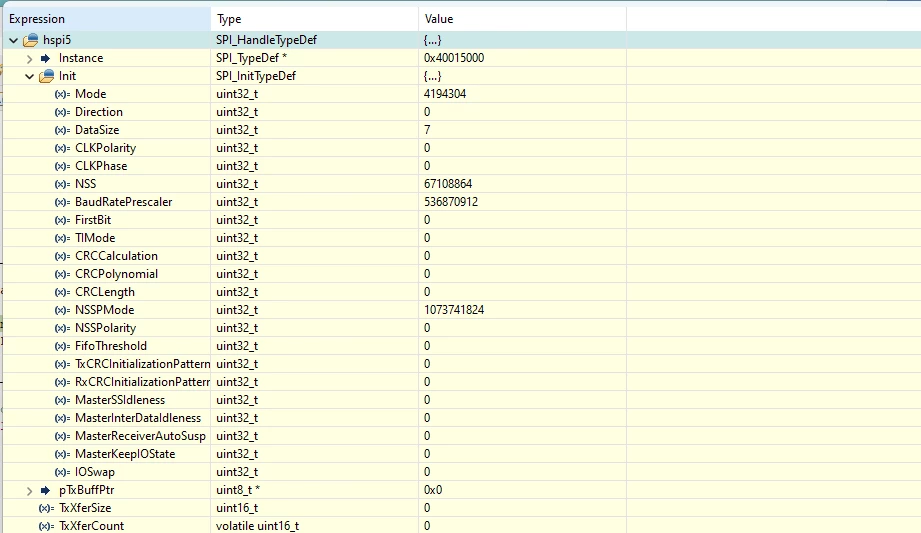

ulao
ulaoAuthor
November 30, 2022
not fully absorbing this. I most certainly can break my code at HAL_SPI_Transmit
I can see all of this

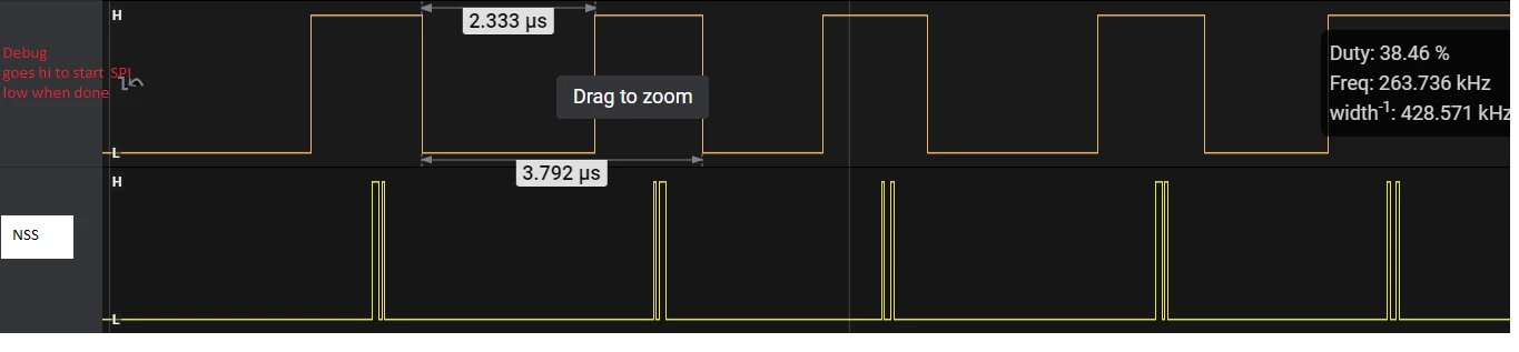

November 30, 2022
I have all the SPI wires on a scope and only the SPI5_NSS / USART7_CTS (PF6/PF9) shows a signal. 0693W00000WJsjaQAD.png
ulao
ulaoAuthor
November 30, 2022
It is also possible its my board I'm using. stm32h735ig

November 30, 2022
oh boy, starting to maybe get this...
So the line I see working is my out data, I know this because changing my data out matches (hard to read without a clock). and my MOSI is configure as PF9 and that happens to be the Pmod 1 (1 SPI5_NSS / USART7_CTS (PF6/PF9) ) Where I see data on the wires
The IOC says SPI5 clock is on PH6 but the board says it can ( or should be ) on PF7/8
So there must be a way to set SCK and MISO to PF pins, but how?
I also see uart7 is in use in my project, maybe this is a conflict?
ulao
ulaoAuthor
November 30, 2022
ah I was able to get it from the LCD connector.
