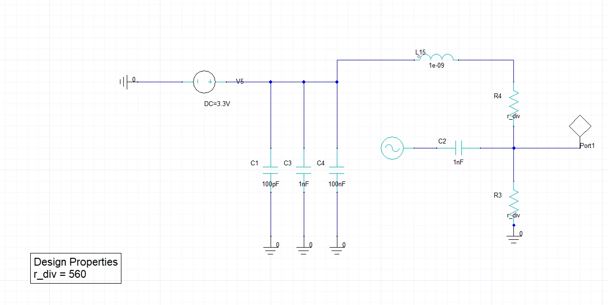

I am planning to use an OCXO (Taitien NI-10M-2503) as the external oscillator (HSE) for synchronizing the MCU to a highly accurate clock source. The OCXO provides an RF output with a sine wave swinging between -2V and 2V.
According to the STM32H533 datasheet, it appears that the input signal on the OSC_IN pin must not exceed Vdd or fall below Vss. In my case, Vdd is 3.3V, and Vss is ground.
I would like to seek your guidance regarding the following:
  1. Based on the datasheet, my understanding is that directly connecting the OCXO output to the OSC_IN pin would not work. Could you confirm if this is correct?
  2. Would it be necessary to use a circuit such as a bias-T to condition the signal before feeding it into the OSC_IN pin?
  3. Are there any example circuits or application notes available for this type of setup?
  4. If there are alternative or better approaches, I would greatly appreciate your recommendations.

10dbm is 2 V pp, not 4 Vpp. Add a capatictor between OXCO out and STM32 Osc_In and 100 Ohm each from OSC_IN to GND and VCC and that should be do the job.

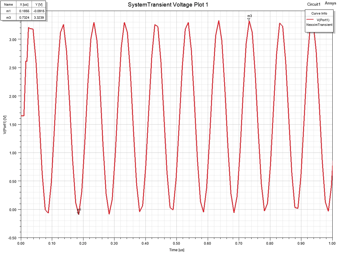

In my simulation setup, I have set the OSC IN resistance at 200 kΩ due to the R_feedback value being 200 kΩ. For the voltage divider resistor, I initially used 100 Ω but found it did not achieve a 3.3 Vpp ; hence, I adjusted it to 560 Ω. Regarding the capacitor for DC blocking, setting it to 1 nF seems appropriate to achieve a 3.3 Vpp signal level.

-> If the RF output of the OCXO ranges between -2V and 2V, it cannot be directly connected to the OSC_IN pin of the STM32H5. When BYPASS mode is used, OSC_IN is a digital input and it requires >0.7*VDD for high level and <0.3*VDD for low level signal. (Refer to Table 39, "High-speed external user clock characteristics (1)", in the datasheet.)
-> Typically, a Bias-T is not used for the OSC_IN pin of STM32 MCU. The OSC_IN pin is intended to operate with standard crystal oscillators or external Clock sources that comply with the specified voltage levels and signal requirements. Before deciding whether a Bias-T is needed, check the output format of the Crystal Oscillator and the requirements of the circuit it will be connected to.

Your OCXO is power by 5 Volt. So absolute highest possible swing is 5 VPP. They guarantee 10 dBm at 50 Ohm, that is 2 VPP. The OXCO output seems to have a capacitor at the output, so you see +/- signal. RM0481 in 11.4.1External clock source (HSE bypass)  talks about what to set for "low swing (analog) " signals.  The needed HSEON bit needed to be set for analog input probably biases OSC32_IN in the right way for AC coupled inputs.
With your 5 Volt OXCO directly connecting the OXCO output  without 50 Ohm termination may cause voltages to high at the input. I assume there is also another consumer for the OXCO, that probably terminates the line. So AC coupled input should be fine. If not, perhaps consider a 3.3V OXCO or terminate OXCO with 50 Ohm and AC couple to OSC_In.
