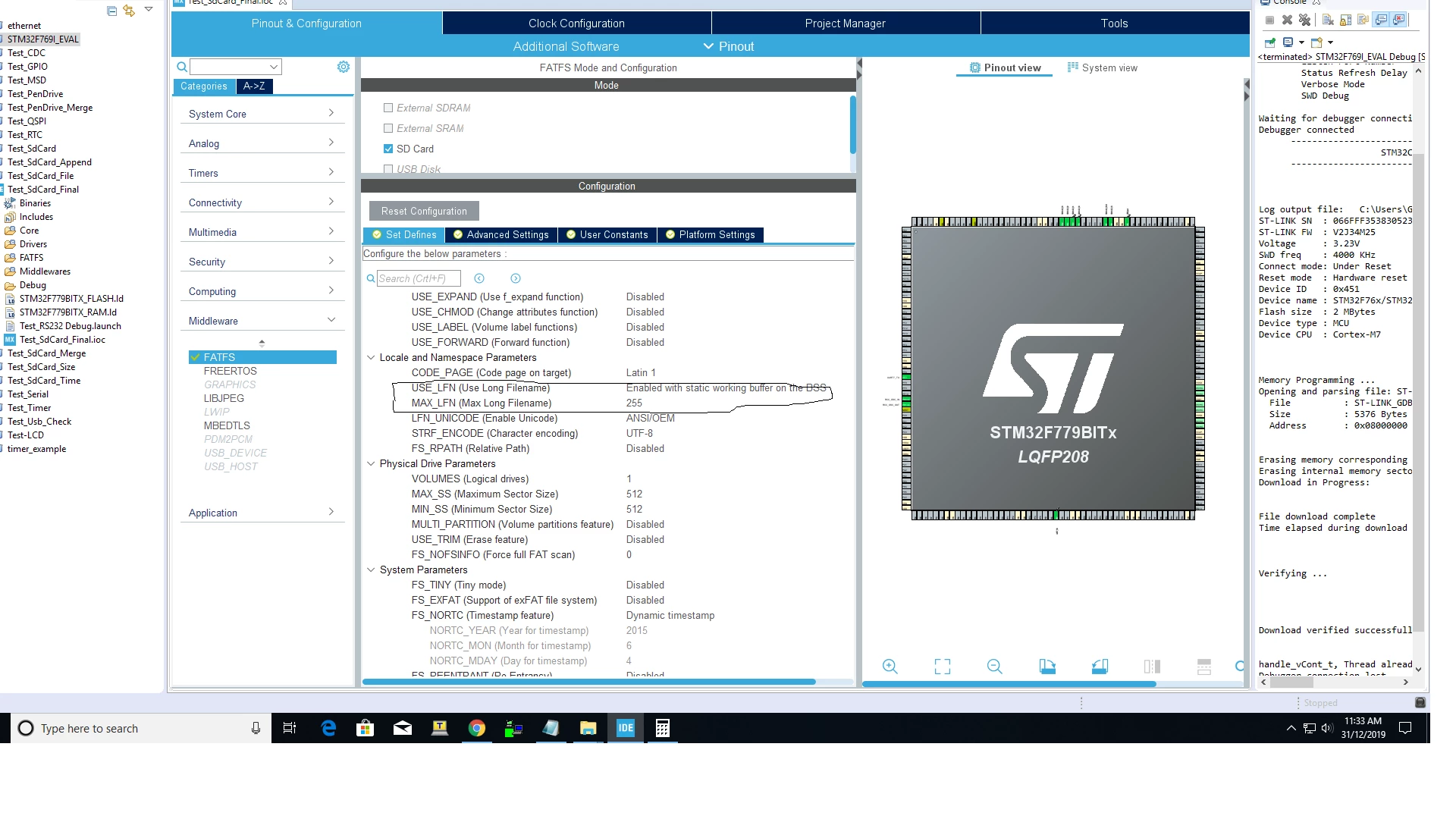

using LFN feature in sd card with stm32f4
Hi,I want to use lfn feature in sd card and i use stm32f4 for this purpose i set _USE_LFN to 1 and _MAX_LFN to 255 . when i create the file , file is created but when i want to return file name , returns wrong.
please guide me, how to return file name when i use lfn feature?
i attache the code.

dbgarasiya
dbgarasiyaBest answer

I am attaching you one screenshot for that

dbgarasiya
Senior
Dec 28, 2019 10:30 AM UTC
you have to update in your .ioc file in Fatfs part
USE_LFN should be enable

dbgarasiya
Senior
Dec 31, 2019 6:01 AM UTC
means in hardware configuration file, where you configure hardware pin for sd card
dbgarasiya
Senior
Dec 31, 2019 6:04 AM UTC
