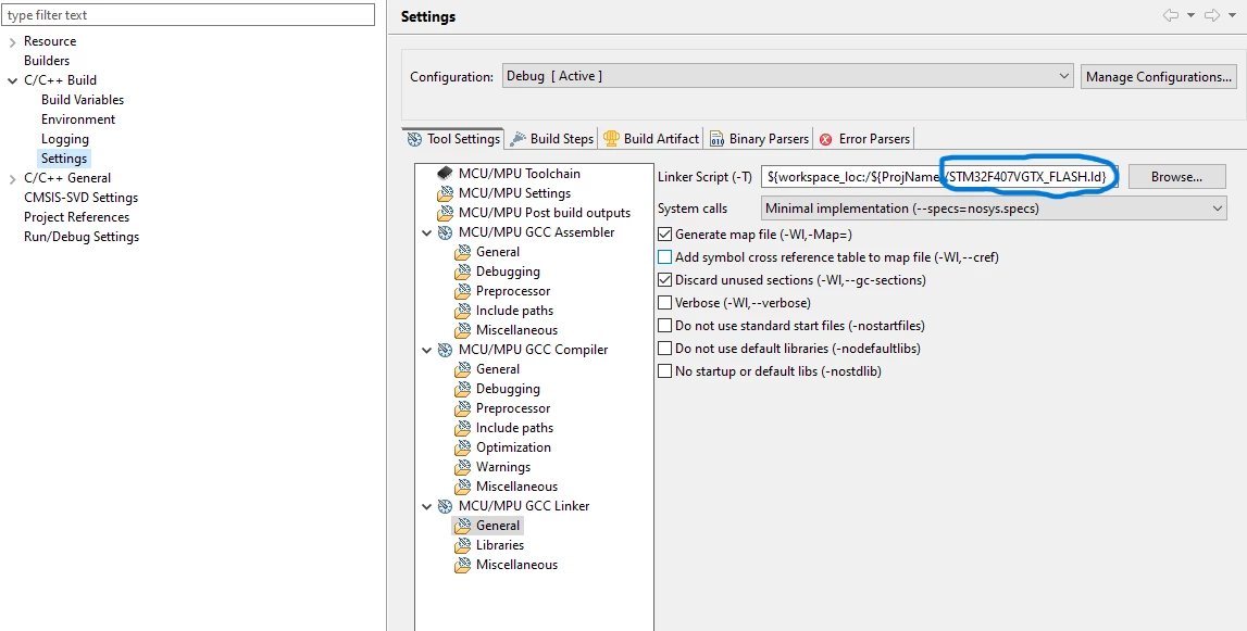

January 1, 2025
I checked my project uses either FLASH or RAM by looking here.Ekran Alıntısı.PNG
In my STM32F407VGTX_FLASH.ld file. It seems OK.

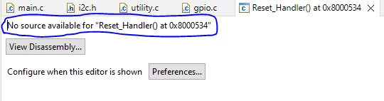

 and I realized somehing I have tried running it several times later on and was receiving this message Ekran Alıntısı.PNG
This must be the problem causing everything goes bad. What should I do at this point. I am quite confused.
Thanks for your attention
