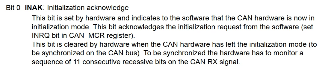

I can understand enabling the CAN1 clock, but the main question I have regarding enabling CAN1 is that the initialization procedure requires reading 11 recessive bits on the CAN RX pin as shown in the screenshot below from RM0430 page 1109. However, the CAN1 RX pin is being used for another peripheral already, so how can the initialization be completed?0690X000006CdwvQAC.png

The CAN peripheral has a loopback mode you can utilize.

In the CAN MSP init function generated by STM32Cube, there is a macro called __HAL_RCC_CAN2_CLK_ENABLE() that is used. On the line above this, I simply called __HAL_RCC_CAN1_CLK_ENABLE() and that fixed the problem.
