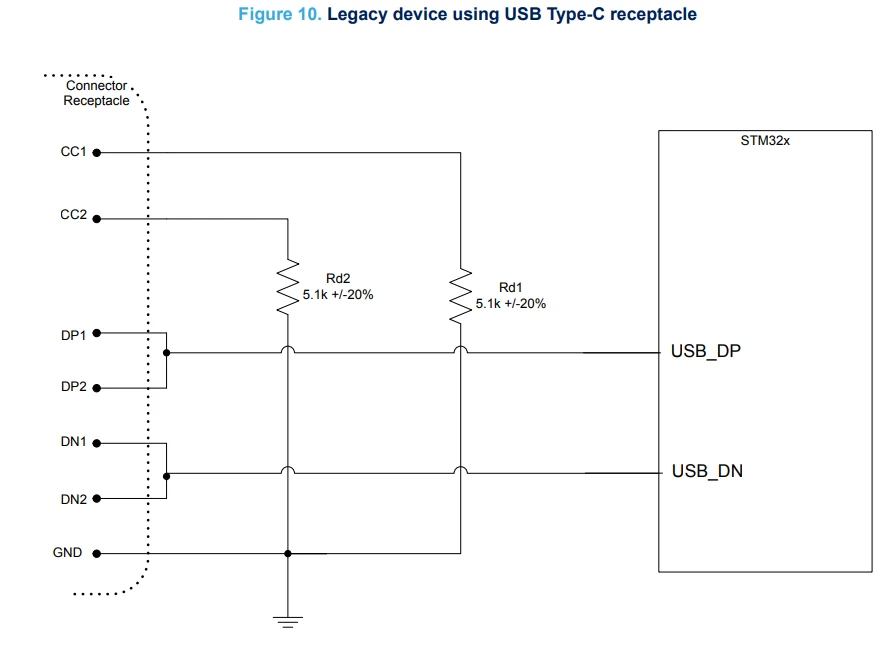

I want to use BC1.2 protocol of STM32G473CE MCU. But STM32G473CE supports USB PD also. So in order to use only BC1.2 can I use only Dp Dm lines of STM32G473CE and leave CC lines un-connected

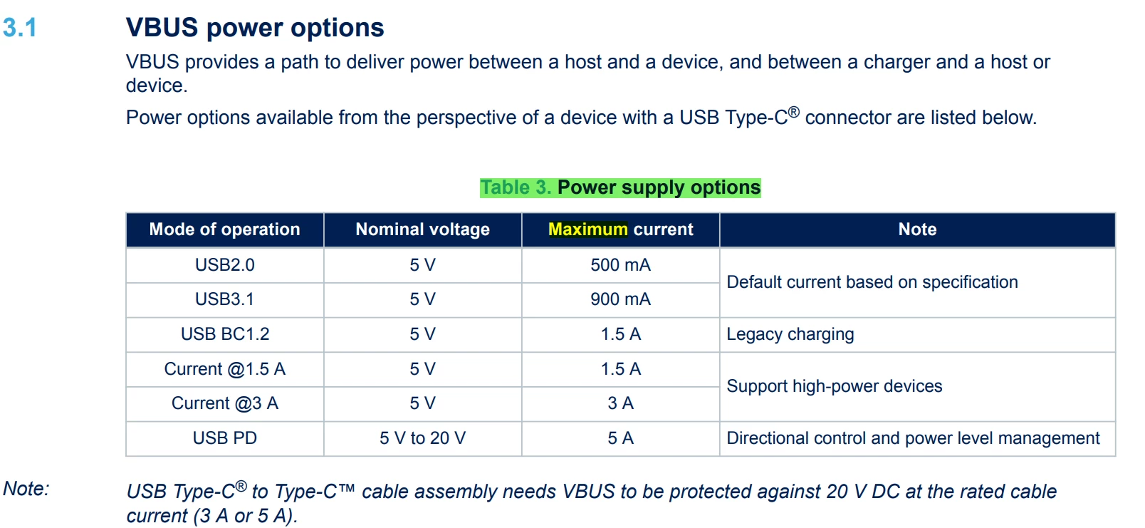

Also what is the maximum power negotiation performed by STM32G473CE when using BC1.2 protocol?

Hello @PY.1
If you would like to use USB 2.0 legacy device to function with a USB Type-C port, you can pull down CC lines to ground as referenced in the figure below extracted from AN5225
According to table 3 : Power supply options, in same App note
 The maximum power would be 7.5W
