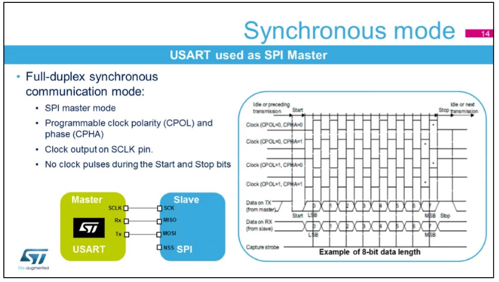

Using an USART in SPI master mode, which pin should be the NSS?
When using an STM32L0 USART in SPI master mode, if the Slave needs a low level at the beginning of the frame and a high after the data byte, can I use any GPIO as NSS master to output this levels?

Apr 15, 2020 10:41 AM UTC
Yes.
I wonder, where this confusing terminology came from. It's *synchronous* mode of the USART, that's why the S in USART...

FBIZA.1
FBIZA.1Author
Apr 15, 2020 12:49 PM UTC
I took this terminology from this ST presentation <USART used as SPI Master (page 14)>. But they don't specify anything about which pin should apply the NSS signs for the slave.
Thanks for your clarifying answer!
