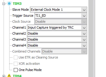

I have a question about using a timer to count pulses form a encoder (only one pin) I don't care about the direction.
I'm trying to use Timer 3, but I'm not sure how to set it up in CubeMx.

Posted on November 08, 2017 at 11:03
On TIM13 you can't - it does not have the slave mode controller needed for external counting modes.
Look into RM, search for SMCR register, look at its SMS field.

Posted on November 08, 2017 at 11:17
sorry for my mistake I meant Timer 3

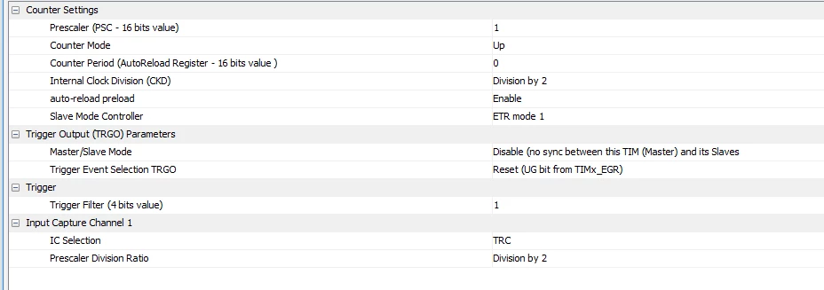

Posted on November 08, 2017 at 11:40
I don't use CubeMX nor Cube.
You want to set TIMx_ARR (I guess it's what is called there 'period') to nonzero.

Posted on November 08, 2017 at 13:22
I think I solved the case.
Counter Period was 0 :(
