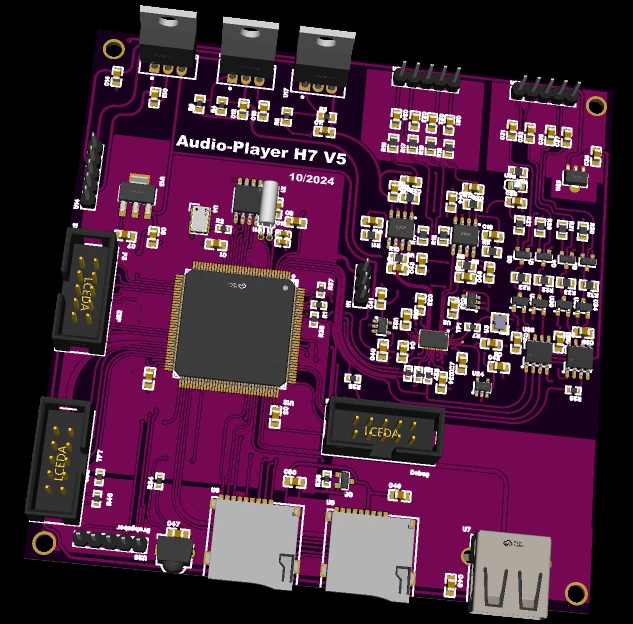

i have the SDcard on SDMMC interface 4bit mode running, on H743ZI (same chip as you).
Speed is about 20MB/s read . (maximum without UHS 1.8V interface/driver - i dont have.)
But my 1TB card is a fake - i checked. (did you check it with H2testw ? )
Need for all big cards : set exFAT enabled in fatfs.
So i just can say: all cards up to my 64GB and the 1TB fake working ok.
Adapter is just standard card holder (2x):
