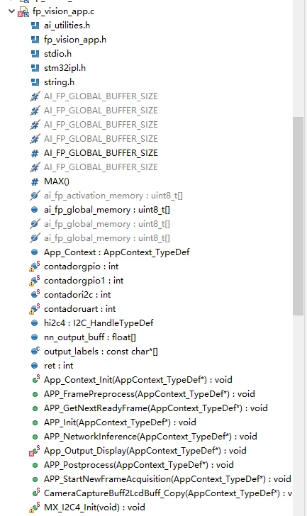

if i use static UART_HandleTypeDef huart8; in main.c . when i want to run it in fpvisionai.c  HAL_UART_Transmit(&huart8,etc) say huart8 undeclared , should i use include <main.h> in this file,o how to set UART_HandleTypeDef huart8 as global variable

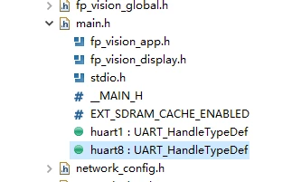

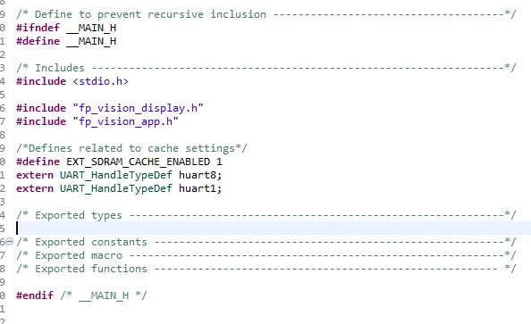

Using "static" means its not visible outside of main.c
Use this in main.h
extern UART_HandleTypeDef huart8;
And this in main.c

still have this trouble fp_vision_app.c:280:25: error: 'huart8' undeclared (first use in this function), should be fp_vision_app.h?
