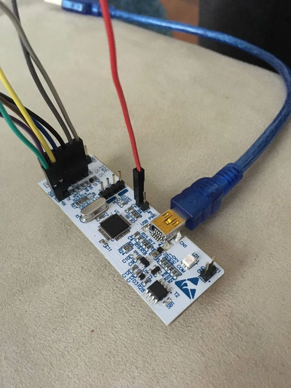

Hi, I have a ST_Link Programmer that was cut off from STM32F411RE Nucleo 64 Board (zero ohms resistors SB12, 13, 14, and 15 have been also removed). I have been use it to program other STM series Board with no problem.
Currently I am doing a project that is using STM32F411RE Nucleo 64 Board and I have a custom made PCB with STM32F411RE chips on it. I tried to use the same ST_Link Programmer to program the chips by connect the 8 pins from the programmer to the chips, but it does not work. The pins are connected the same as how I connect my programmer to the nucleo board.

With the connection above, I can program my Nucleo board with external ST-Link programmer that I cut off before. Everything works fine.

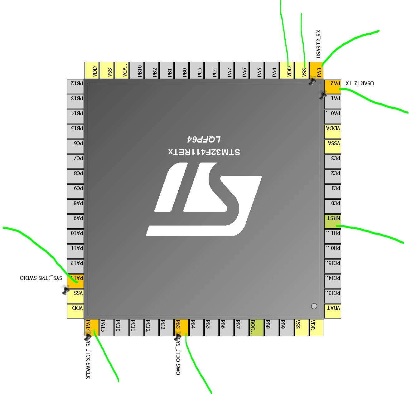

And then I connected the same programmer to my STM32F411RE Chips with the same pins as following:
Programmer
STM32F411RE MCU
Left Pin from JP1 (next to USB Power)- - - - - - - - - - - -VDD (Pin 19)
SWCLK (CN4-2)- - - - - - - - - - - - - - - - - - - - - - - - - - - - - -PA14 (Pin 49)
GND (CN4-3)- - - - - - - - - - - - - - - - - - - - - - - - - - - - - - - -VSS (Pin 18)
SWDIO (CN4-4)- - - - - - - - - - - - - - - - - - - - - - - - - - - - - -PA13 (Pin 46)
NRST (CN4-5)- - - - - - - - - - - - - - - - - - - - - - - - - - - - - - -NRST (Pin 7)
SWO (CN4-6)- - - - - - - - - - - - - - - - - - - - - - - - - - - - - - - -PB3 (Pin 55)
TX (CN3-1)- - - - - - - - - - - - - - - - - - - - - - - - - - - - - - - - - -PA3 - RX (Pin 17)
RX (CN3-2)- - - - - - - - - - - - - - - - - - - - - - - - - - - - - - - - - -PA2 - TX (Pin 16)

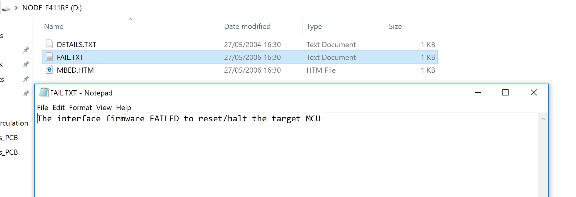

This time, when I connect the program to my computer, same storage disk (NODE_F411RE (D:)) has jumped out, however, in stead of usual two files (
DETAILS.TXT and
MBED.HTM), there is one additional file called
FAIL.TXT, and when I opened it out, it shows:
The interface firmware FAILED to reset/halt the target MCU.
I am not sure how to fixed this, if anyone can help, that would be appreciated.

    More indicative of VDDA/VREF+ not being powered. Also want capacitors on VCAP pin(s).

    Hi, thanks for the reply. So do I connect Left Pin from JP1 (power) to VDDA/VREF+?  What is VCAP pin(s)? and what size of capacitors that I should use? Thank you.

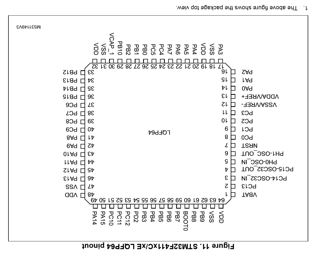

    There's a manual for the part that's worth reviewing
    http://www.st.com/content/ccc/resource/technical/document/datasheet/b3/a5/46/3b/b4/e5/4c/85/DM00115249.pdf/files/DM00115249.pdf/jcr:content/translations/en.DM00115249.pdf
    Single VCAP pin (30) would need a 4u7F, it's the bulk capacitor for the 1.25V regulator powering the core. The VDDA/VREF+ powers the analogue circuitry (so POR and PLL/VCO as I recall), no power there device held in reset indefinitely.
