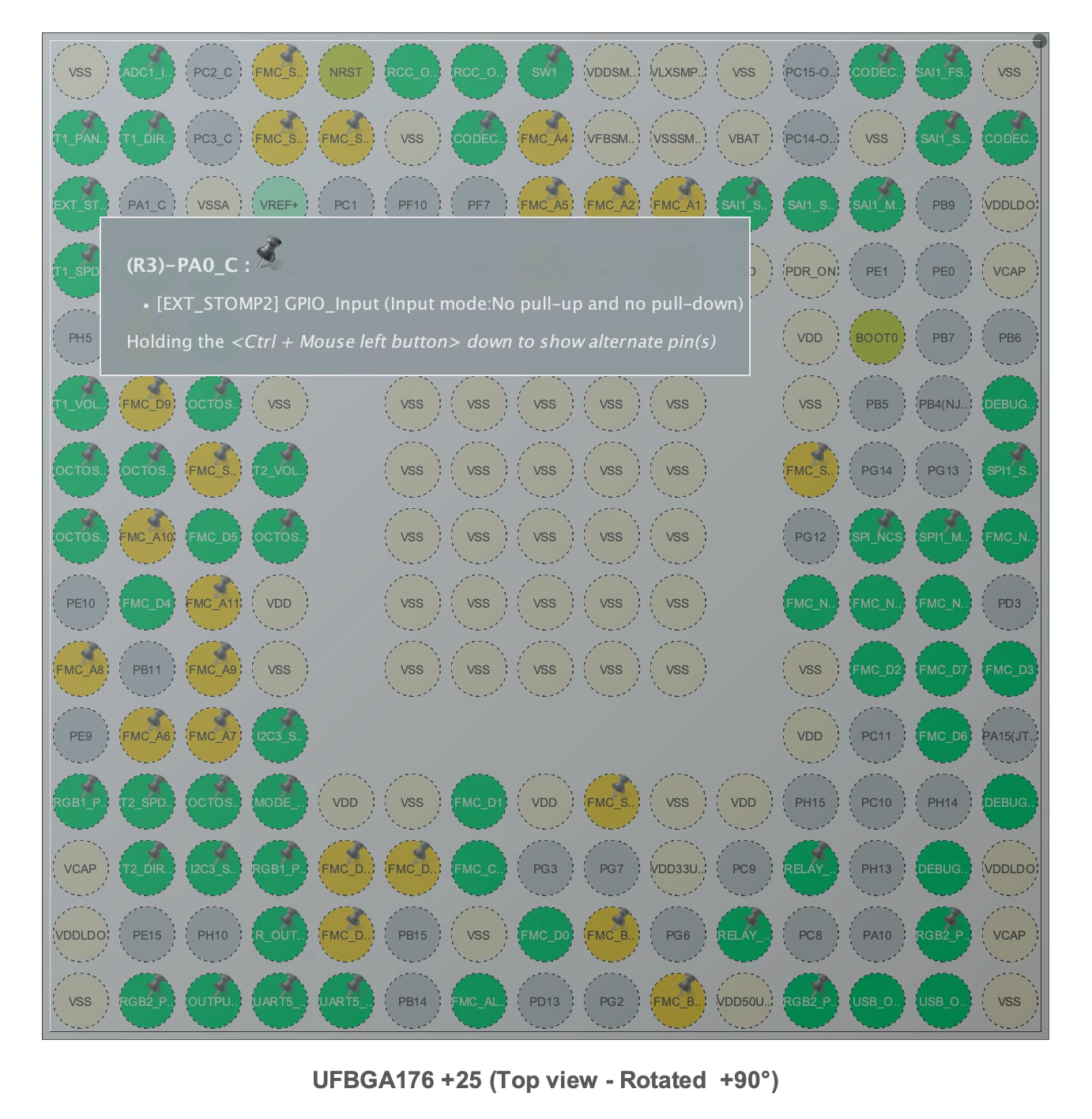

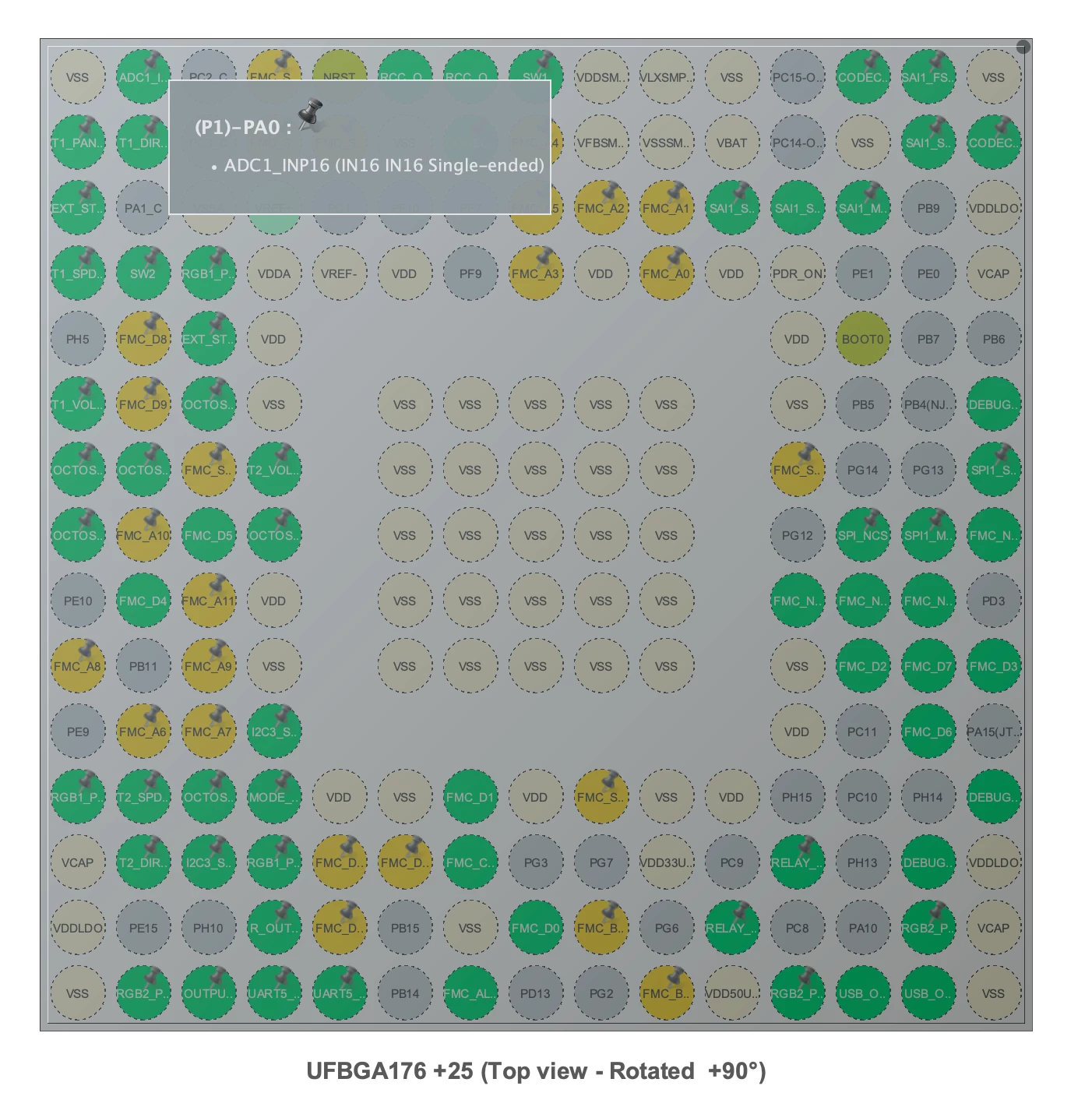

Sharing screenshots of PA0_C and PA0 configuration. Note that PA0_C does not work even if I deactivate the ADC function on PA0.

June 10, 2025
PA0_C cannot be used as a GPIO independently of PA0.
You cannot use PA0 as an ADC and PA0_C as a GPIO.
You can use PA0_C as an ADC pin and PA0 as a GPIO.
If you're having issues or think an IOC is generating bad code, please attach it here so someone can take a look.

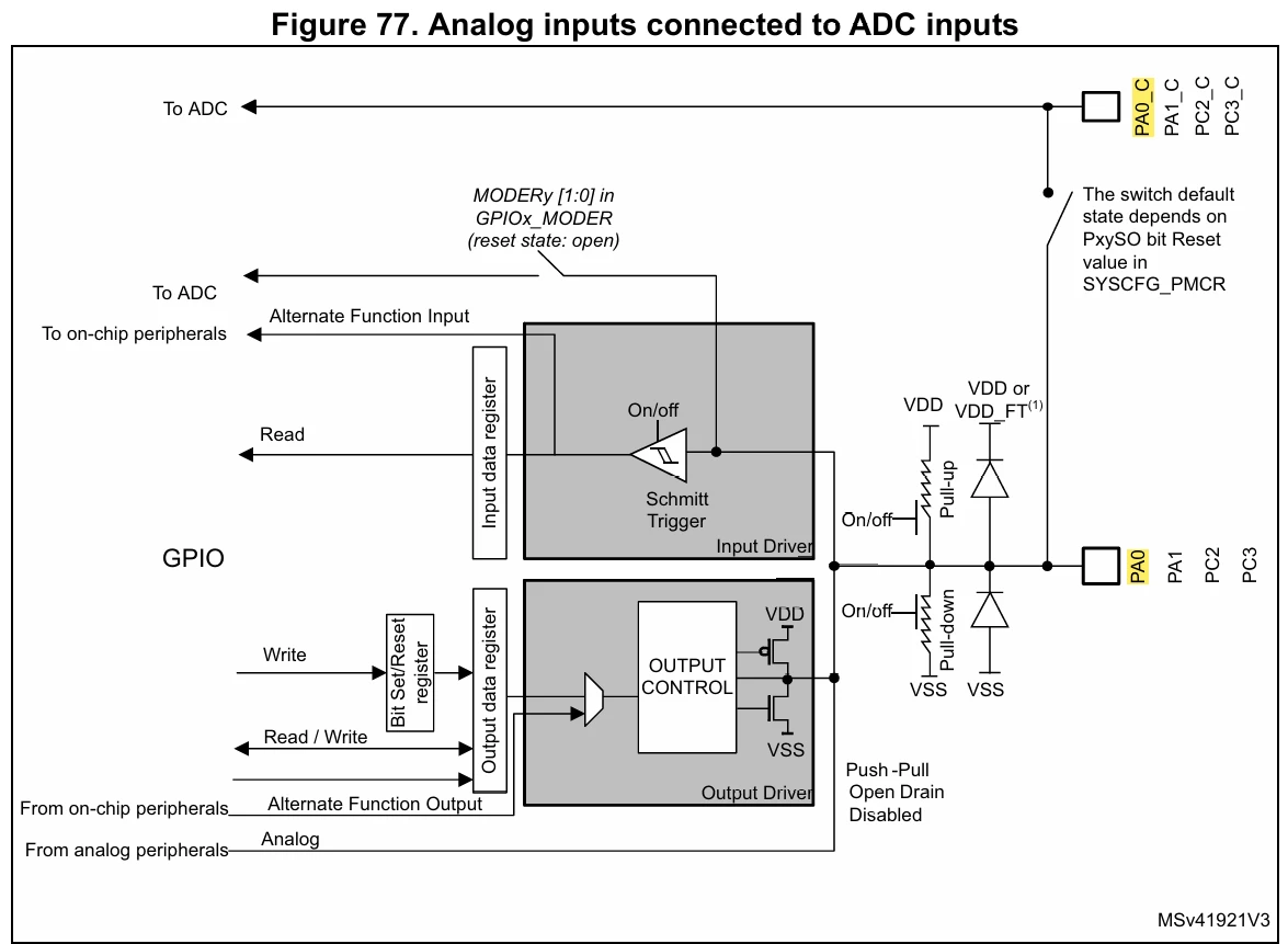

June 10, 2025
Sometimes software has bugs. The latest STM32CubeMX version doesn't allow you to do this. You're a few versions behind.
The Reference Manual seems consistent to me in explanation, especially Figure 77. Only thing PA0_C can do on its own (i.e. without the analog switch) is ADC. When the switch is closed, the two pins are tied--they are no longer independent.
