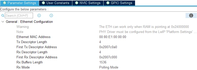

Here is some of my setting

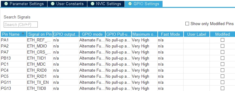

A:Connectivity TAB
1. ETH enabled, LWIP driver DP83848 selected (only this is available. Some used another LANXXXX driver,  never seen in my IDE)
2. corrected ETH TXD1 after referring to Nucleo's user guide pdf, it was previously automatically set to another pin. What a *** bug...
3. NVIC global interrupt Ticked. (many example use it, so I followed)

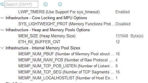

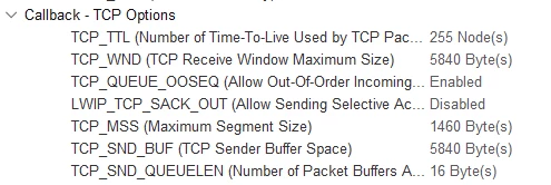

B: LWIP setting:

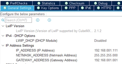

1. Set IP. The rest Default.
2.  Key Option: I followed Adam's setting. I don't understand these here, I just followed Adam (URL above).
Many experts shared to set LwIP heap Pointer address. F767zi does not have that setting available even "show advance parameter" is checked. So I didn't set as shown by Adam's post.

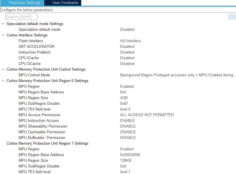

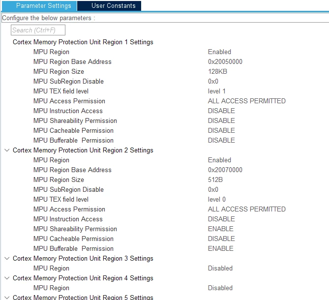

C: Cortex M7 setting
I don't know why these is needed, just follow and adjust linearly from Adam post.

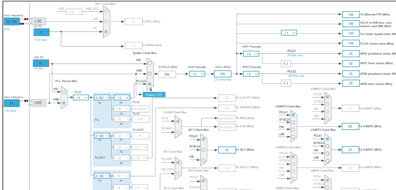

D:Clock to 400MHz
Adam set the SysClk to 400.
I cannot get it to 400 in F767zi, it is RED in the maximum available divider and multiplier.
I tried to maximize it to 200. I wonder if this is critical.

Hello @Wai Siang ,
I'll try to give you a quick guide on how to make it work on the Nucleof767 here is the steps I followed to make it work:
1- configuration of ethernet and pin assignment
2- configuration of Lwip with the correct Network interface (PHY) LAN8742 (you will find all configuration in the .ioc file)
3- disabled DHCP to assign a static IP address
4- make sure ICMP is activated in order for the ping command to get a response
5-genrated project using CubeIDE
6-added the following section in the flash.ld file to place the DMA descriptors of Ethernet in a specific memory location as they are sensitive to segmentation and unaligned access.
 .lwip_sec (NOLOAD) : {
 . = ABSOLUTE(0x2007c000);
 *(.RxDecripSection)
 . = ABSOLUTE(0x2007c0a0);
 *(.TxDecripSection)
 } >RAM AT> FLASH
7-in the while(1) of the main.c file add
	 MX_LWIP_Process();
	 HAL_Delay(1);
for periodic handling
8- download the Firmware and test the application by ping 192.168.1.x(15 in the shared working example)
Hope this helps.
