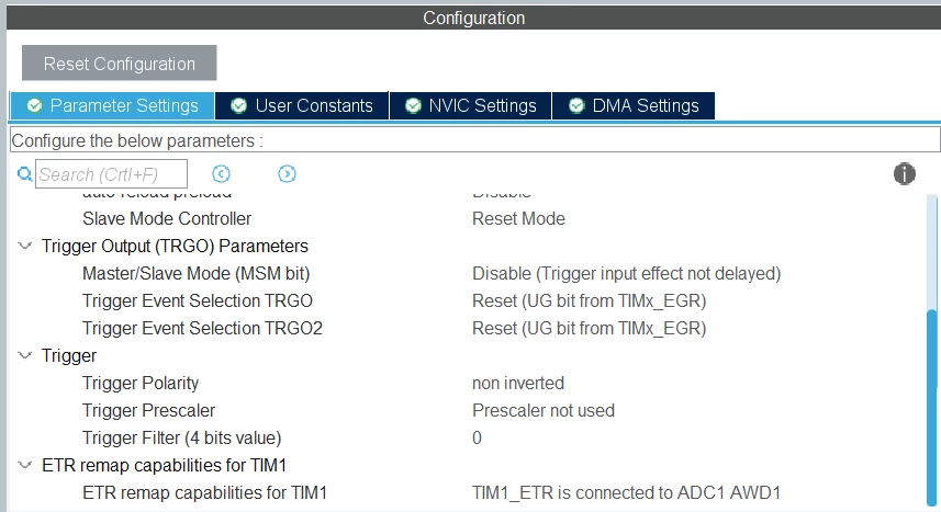

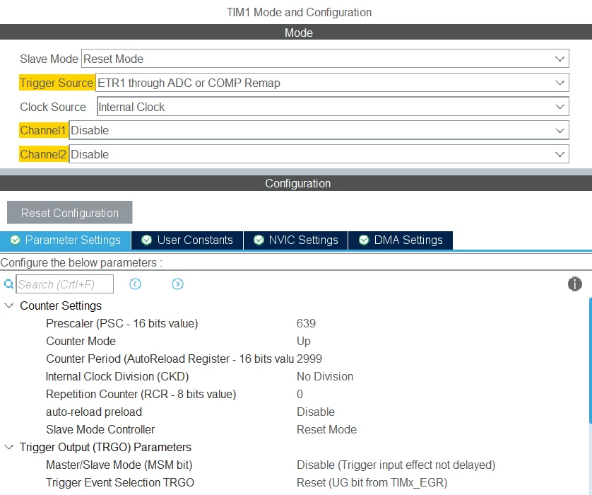

Use Analog Watchdog (ADC AWD) as a reset for timer.
I've to count till 30ms, but i've to restart the count if a signal goes above a threshold. So i want to use analog watchdog as trigger source for the timer.
I set up the timer in "slave reset mode" and with "ETR1 through ADC" as Trigger Source. I've also set ETR remap capabilities for TIM! in the correct way. The problem is that the timer never reset so it count to 30 ms every time. Anyone have any advice?

Which STM32?
How is ADC running? Observing it's registers, does it set the watchdog flags as expected?
Have you verified this by reading out and checking the TIM registers content?

Thanks for the reply.
i work with a STM32WB50.
ADC is running ok, AWD1 interrupt flag is set to 1 when the signal is outside the window and to 0 otherwhise.
ADC1_AWD1_OUT is the signal that trigger the timer, but i don't know where to check its value.
The TIM register seems okay

waclawek.jan
May 27, 2021 10:44 AM UTC
Show.

May 27, 2021 12:21 PM UTC
I find the problem. ADC1_AWD1_OUT stays high so it trigger the reset of the timer only when it goes from 0 to 1. In my application the signal is stable outside the ADW window and i wrongly assumed that this situation will have caused a continuos reset on the timer unless there is a voltage drop outside the window.
