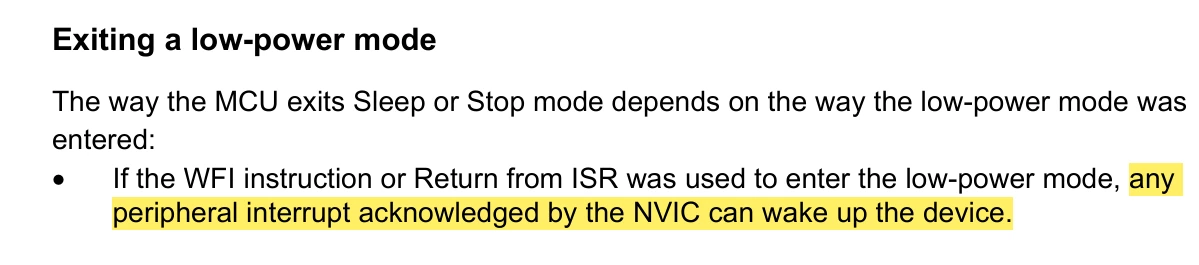

Should be working. Any interrupt is able to wake the processor out of sleep mode from WFI. No special setup required.
If you don't disable systicks, do systicks wake it up?
> But I'm not getting out from the Sleep mode
How exactly are you determining this? Have an LED light up only when you're in sleep mode. Ensure it goes off.
Are you entering sleep within the main thread? It may not work as you expect if you're in an interrupt.

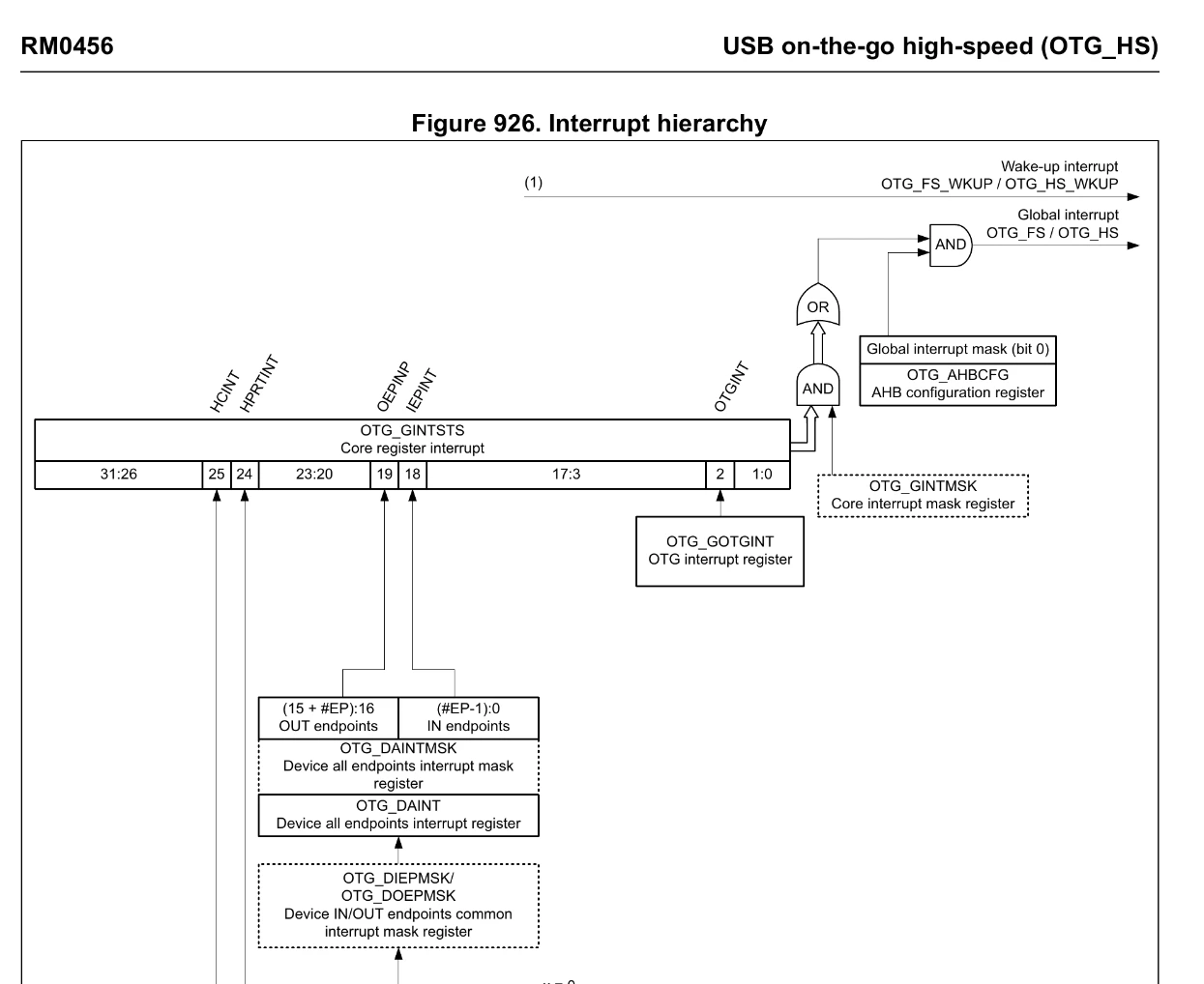

However I checked the RM0456, which is referred to the STM32U5 series MCUs and it shows the the OTG_FS_WKUP / OTG_HS_WKUP line. Screenshot_20250618_112544.png
Jun 19, 2025 1:53 PM UTC
Hi @j_filipe
In footnote, it is noted:
1. OTG_FS_WKUP becomes active (high state) when resume condition occurs during L1 SLEEP or L2 SUSPEND states.
This is not direct EXTI wakeup.
You can refer also to Table 190: EXTI line connections: we don't have direct USB wakeup over EXTI on STM32U5.
You have 40ms to detect vbus cable loss.
With aggressive low power mode, we can poll SESSVLD in OTG_GCCFG for about 40 ms every 25us to monitor vbus state. There should be no event generated.
To give better visibility on the answered topics, please click on "Best answer" on the reply which solved your issue or answered your question.Best regards,FBL
