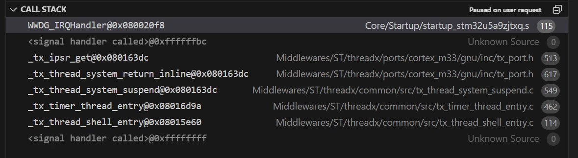

I am unable to make working ThreadX USBX Host example for STM32U5 adopted for Nucleo-U575ZI-Q.
All, but the last setup step described in Introduction to USBX section 3.3 complete properly, but when finally HAL_HCD_Start() is called, ThreadX crashes. What could be wrong/missing?
System crashes even before OTG_FS_IRQHandler() is called. HSI48 clock has correct frequency, I measured it.

Problem solved. CubeMX does not recreate the correct required "startup_stm32u575zitxq.s" file, so file taken from the original example for the wrong MPU was used, with a different USB ISR handler name: OTG_FS_IRQHandler vs OTG_HS_IRQHandler.
Probably it is a CubeMX bug.

Which CubeMX version used? If possible, share you ioc file. We will try to reproduce your issue and raised the issue internally for working.

I use the latest version 6.9.2. It is quite easy to reproduce. Just rename xxx.s file in /Core/Startup (STM32CubeIDE config) to something else and generate code again. The file will not be replaced or recreated if removed.
