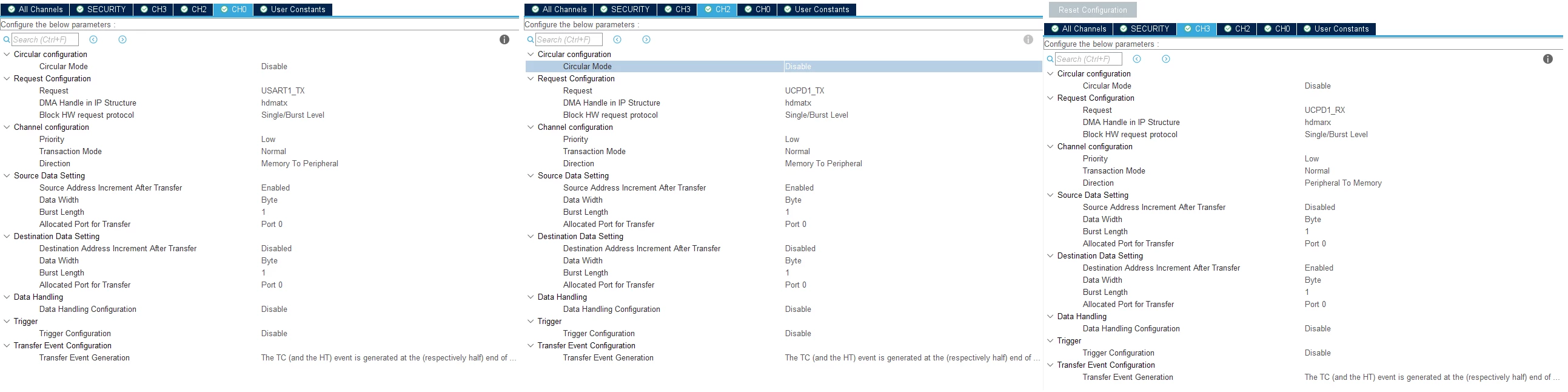

- Set the DMA settings of UCPD1 and USART1 (here I have used the settings of the working CubeH5 project)

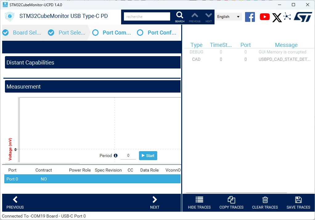

I added the define TCPP0203_SUPPORT manually. Now I see:
0 DEBUG 0 0 ADVICE: Update BSP_USBPD_PWR_SetRole
1 DEBUG 0 0 ADVICE: Update BSP_USBPD_PWR_SetPowerMode
2 DEBUG 0 0 GUI Memory is corrupted
3 CAD 0 0 USBPD_CAD_STATE_DETACHED

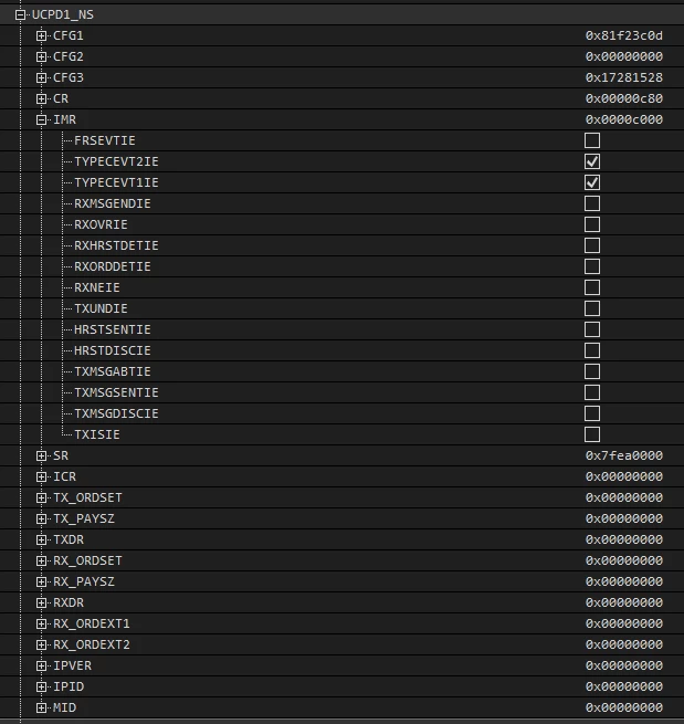

I found also out, that the UCPD1_IRQHandler is hit only one time. But the interrupt is on:
