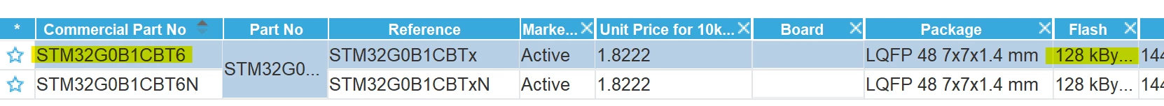

I am working on an STM32G0B1CBT6

The STM32G0B1CBT6 chip has 128 kB of flash. Address 0x803F800 is past the end of the flash which is at 0x08020000.
