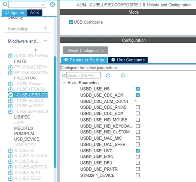

    it is a shame that CubeMX does not support a video class (uvc) for USB or a combination of several device classes. After one day of searching examples i found a "software pack" for CubeMX:
    alambe94/I-CUBE-USBD-Composite: Create STM32 USB Composite devices with ease. (github.com)
    here a small uvc example I created:
    mkoenig334455/-USB_Video_STM32F407VGTX: STM32F407VGTX + USB3310 example / enumerate as webcam and show 2 pictures as videostream (github.com)
    ST, please support this project and promote it, so we all can save lifetime!
    I use:
    CubeMX 6.10.0
    CubeIDE 1.14.0
    Processor: STM32F407VGT + PHY USB3310
