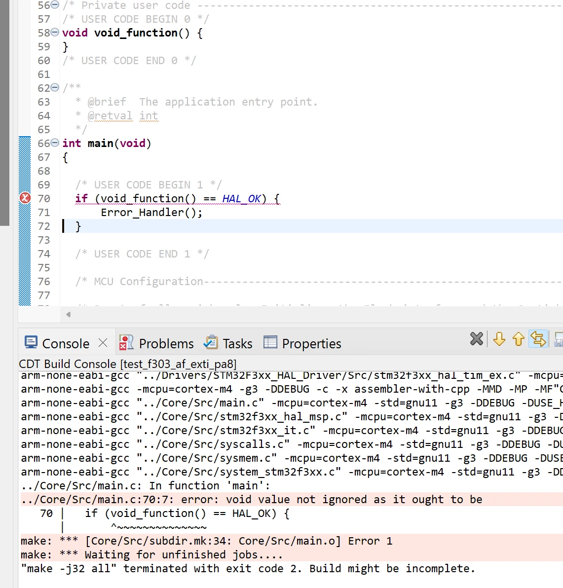

This shouldn't even compile. HAL_PWREx_EnableUSBVoltageDetector does not return a type.
stm32h7xx-hal-driver/Src/stm32h7xx_hal_pwr_ex.c at d649ed2c7784bfbef4be144e7bfd8dbb41dce5c3 · STMicroelectronics/stm32h7xx-hal-driver
If CubeMX is generating this, it's a bug in CubeMX. Please attach your IOC file.
Andrew Neil
November 6, 2025
But, in an expression, the function still has a value - which is its address.
So it should compile - but it won't do what's intended!
Agreed!
November 6, 2025
A void function does not return a value and cannot be used in an expression.
Its value is not its address--that's nonsense.
