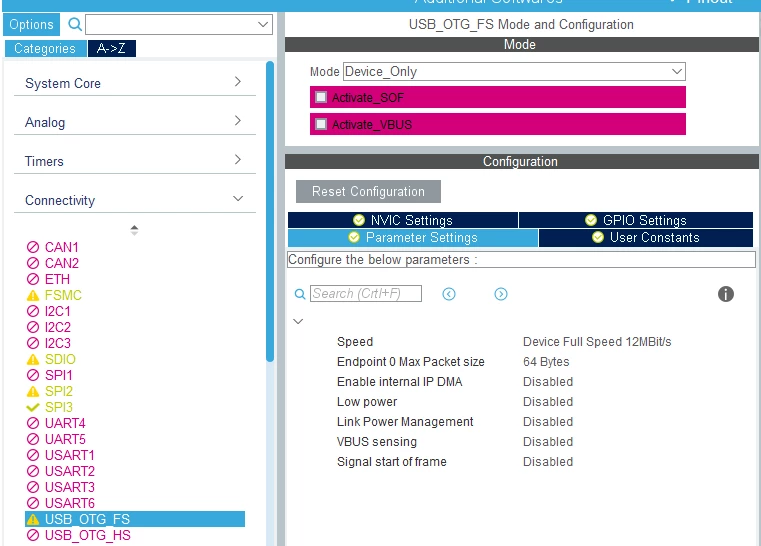

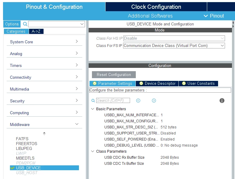

    Hi all,
    using windows 10,
    I want to handle STM32F407 Disco via VCP. In the first case, i tried to configure UART but when i connect my USB TTL converter to my PC: it informs me that VCP error ''This device cannot start(code 10)''.
    I thought that the probem is related to my USB converter
    Then i tried to configure CDC USB:
    USB_OTG_FS on mode Device only
    activate USB_Device middelware in CDC mode
    check the CubeMX file attached for more details
    but the problem still exist!===> VCP error ''This device cannot start(code 10)''.

    I have the same problem like you @med zarat ''This device cannot start(code 10)''.
    Magically that when I change Heap Size from 0x200 to 0x1000 and Stack Size from 0x400 to 0x500, it will work.
    I can see that both your Heap Size and Stack Size are 0x1000, but I do not why it is sill in that problem.
    I think this is the problem related to memory.
    Maybe you can change the buffer size of the USB?
    This is my setting in STCube. Hope that it will be usefull.
