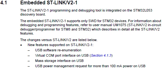

    It is a faux MSC presented by the ST-LINK's STM32F103 to allow flashing of the part it has as a target. This is how it implements mbed flashing. ie it pretends to be a drive with a FAT file system

    There's been a few threads here asking if this pseudo-drive can be accessed from the Target.
    IIRC, the answer is, 'No' for ST boards (but some other mbed implementations do support it).

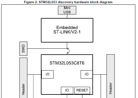

    Andrew Neil
    Feb 22, 2018 9:49 AM UTC
    Posted on February 22, 2018 at 09:49
    Your original question was specifically about the Discovery Kit.
    If you look at the User Manual for the discovery kit, you will see a diagram like this:
    The box marked ''Embedded ST-Link/V2-1'' is what provides the USB connection to your PC
    If you want to directly connect your target STM32 to USB, then you will ned:
    1. An STM32 with built-in USB hardware;
    2. The appropriate USB software stack on the target STM32

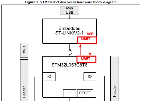

    The diagram doesn't show it, but the Virtual COM port works like this:

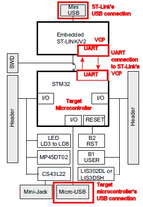

    Andrew Neil
    Feb 22, 2018 10:20 AM UTC
    Posted on February 22, 2018 at 10:20
    Perhaps this helps to distinguish the USB connection via the on-board ST-Link from the Target microcontroller's own USB connection:
    See:
    https://community.st.com/0D50X00009XkfBTSAZ
