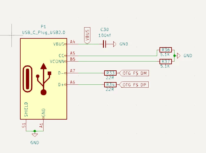

I have made my own PCB with STM32F427VIT6 for a project. But if I tried connecting with the cube IDE, I could not connect it through the Type C port, I could only connect it with STlink. Even my laptop doesn't detect the port. Can anyone help debug this issue?

What you do (in your program) with the USB ?  host? device ? mode ?
Just "connecting" the pins - will do nothing. (except bootloader/firmware, if boot0 hi.)

I tried uploading the firmware through Type C, but I couldn't so I did it with stlink. my boot0 was high when I tried with type c.

So you/it had : boot0 hi , then (hard) reset ... ? (boot only checked at end of hard reset)
Then you should see it in CubeProgrammer, in dfu mode, to connect . (Might need USB plug out -> in , to let the system check: new device here now.
