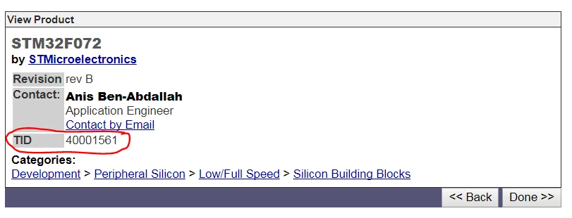

Any one know what is USB TID? And, have some one know how to get the ST USB TID number?

    First hit simply googling 'USB TID':
    http://www.usb.org/developers/compliance/cable/
    Note:
    T
    est
    ID
    s (
    TID
    s) are assigned by the USB-IF or by the certified independent test lab at the time of testing.

    I don't think you can use a TID to side step the USB certification of your own product.
    In the case of USB-C part of the certification is presumably you have a compliant driver.

    Hello
    Wu.Jyunwei
    As mentioned by
    Neil.Andrew
    , Test IDs (TIDs) are assigned by the USB-IF or by the certified independent test lab at the time of testing.
    In order to get the TID number of a certified USB , you have to visit the
    http://www.usb.org/kcompliance/view/catalog_search/sselect_item/process/refresh?profile=b53bcd5efdcd514ee2b6df3a16feb10f5294b275&referring_url=http%3A//www.usb.org/channel&keywords=STM32&step%3Aint=2&tab_data_namespace=28681966A78ZIB4vgcw&sitemlist_batch_start%3Aint=1
    Below, you find an example of the STM32F072(LS/FS):
