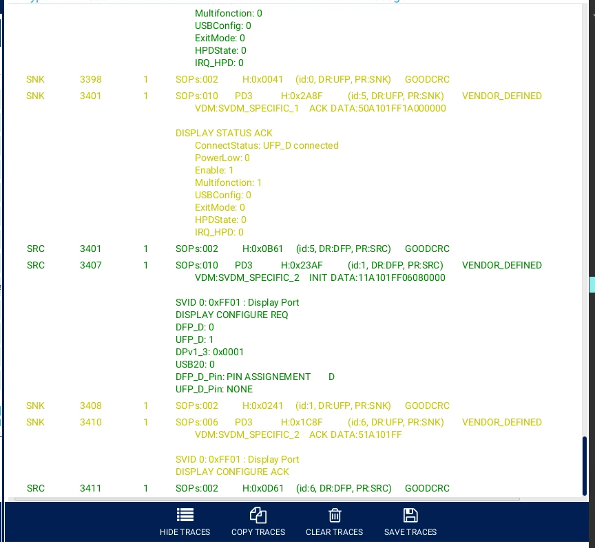

When i call
* USBPD_PE_SVDM_RequestAttention
I get a OK message response but the callback never gets called.
* USBPD_VDM_SendAttention
Curious to know if there's any good way to debug this?
Current debugging steps
I have a STM32G0-Disco board setup to capture the messages over USB-PD and display them with ST's USB-PD monitoring software.  So i know the attention pin is not currently activating.  I have a breakpoint to make sure that USBPD_PE_SVDM_RequestAttention is being called.  If i wait a few seconds and then trigger it to call USBPD_PE_SVDM_RequestAttention again i get a BUSY error.  So i figure it's trying to send it, it just can't?

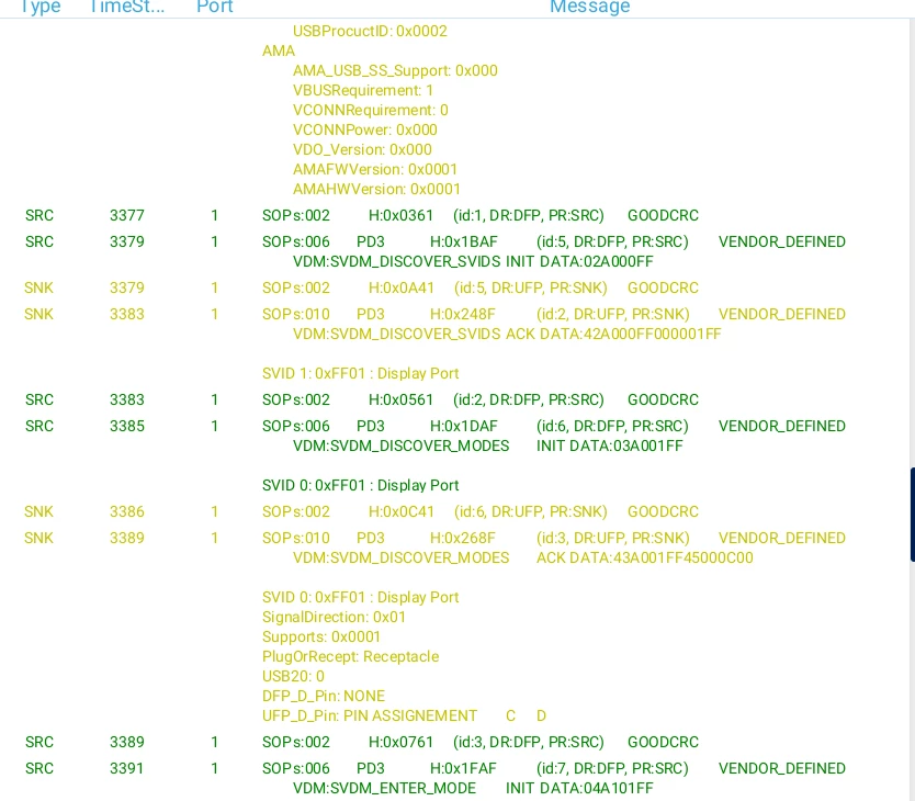

PD captures

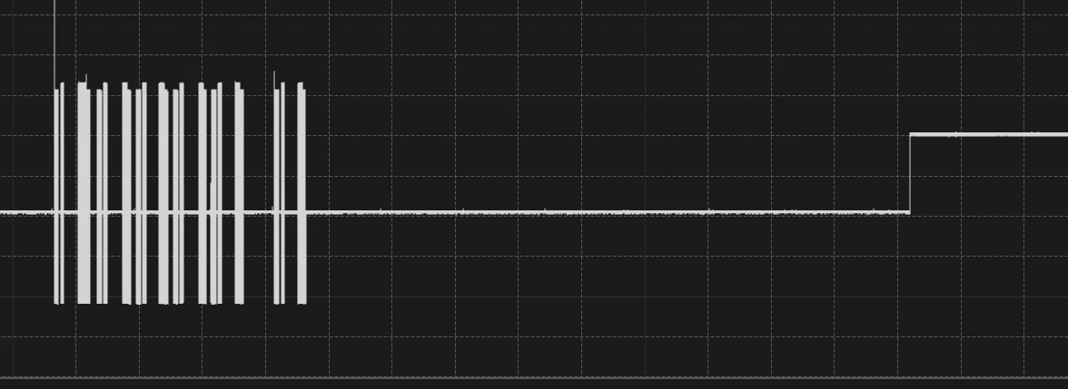

Best answer by Brenden_PLUS
Problem.
  • So i had Dead battery enabled but i wasn't connecting it up.
  • Instead i was using 5.1KOhm resisters attached to CC lines.
Thing to note are that by default the dead battery pins are set to the resister for 1.5 amps.  But in the demo code i think they must be setting them to the 3.0 amps resister.  I'm going to continue to leave this post open  until i fully understand why this worked?

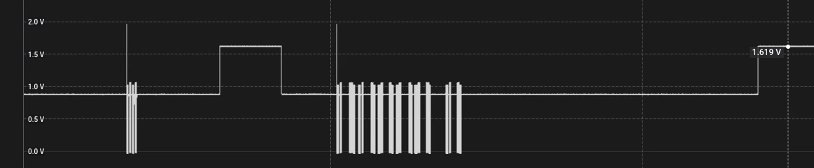

So does the internal UCPD hardware block have the ability to detect voltage level.
I'm fairly certain i'm in a explicit contract since i've entered the mode and have setup the thing to do Display port.
So the only reason from a pure signal perspective that would cause it to not work is if the voltage level was wrong or it wasn't setup properly to read the voltage level.
In the code i'm working on i removed the ADC channels that all the examples had.  So usually there's a VBUS sense and a ISense in the examples.  Which i don't think really matter for my case since i actually don't want to change the voltage away from just a standard 5v signal.
I'm fairly curtain it must have the ability to measure the voltage, but just checking.
So this is what the transaction looks like and it seems like it does find it's resting voltage.  So i should be able to send a attention without problems.  Granted it rest at like 0.8V which seems kind of low.  The data range is 0-1.0v.
Brenden_PLUSAuthorBest answer
Senior
January 20, 2026
Problem.
