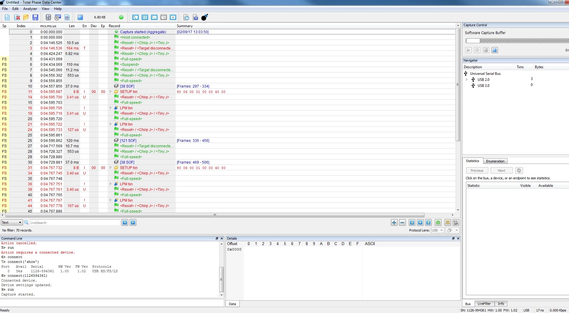

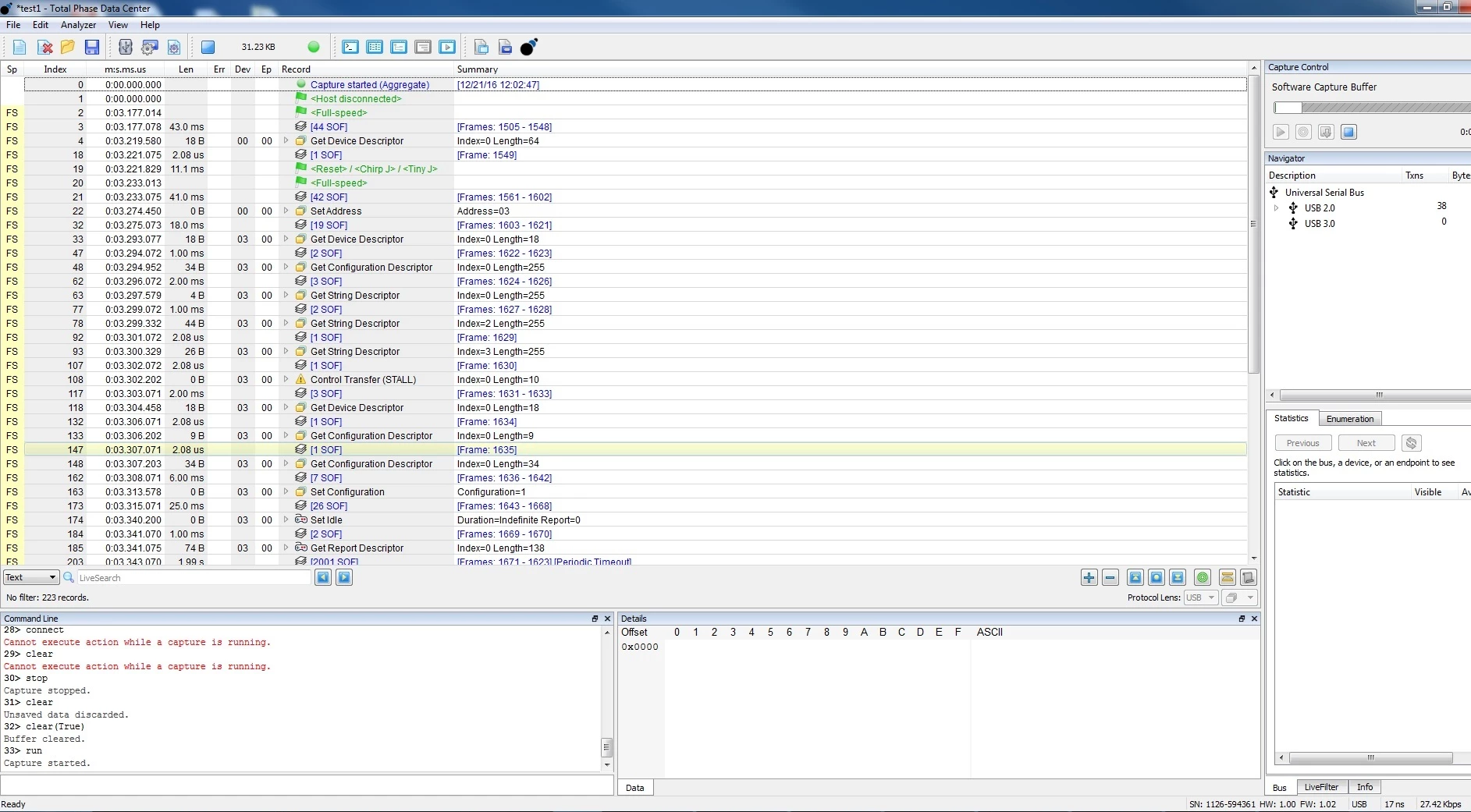

I am currently trying to get USB OTG FS working with STM32F412/411 MCUs in device mode but unfortunately the PC doesn't recognize the device. Cannot figure out if it is a hardware or software problem because I do not have a proper code which is proven to be working on STM32F412/411. STMCubeMx generated code for USB_FS_OTG_Device mode also doesn't work for any of STM32 MCUs (tested on STM32F429IIT6, STM32F412/411). I do have a working application for STM32F429IIT6 in USB_OTG_HS_Device mode but this code doesn't work for STM32F412/411 after modifications to USB pins and clocks even though the USB OTG circuit is similar in both cases. The USB Analyzer shows that the device doesn't respond to the packets sent by the Host. Please find attached the USB analyzer screenshots of working USB device on STM32F429IIT6 and not-working USB device on STM32F412. Could someone share a working USB OTG FS Device mode code for STM32F412/411 please or anyone who had the same problem and found a solution please share your ideas. Thanks!

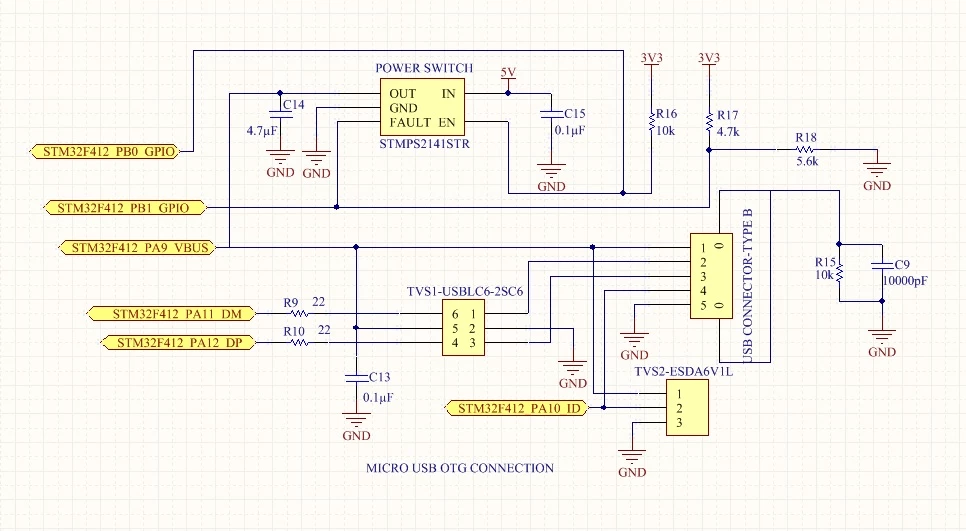

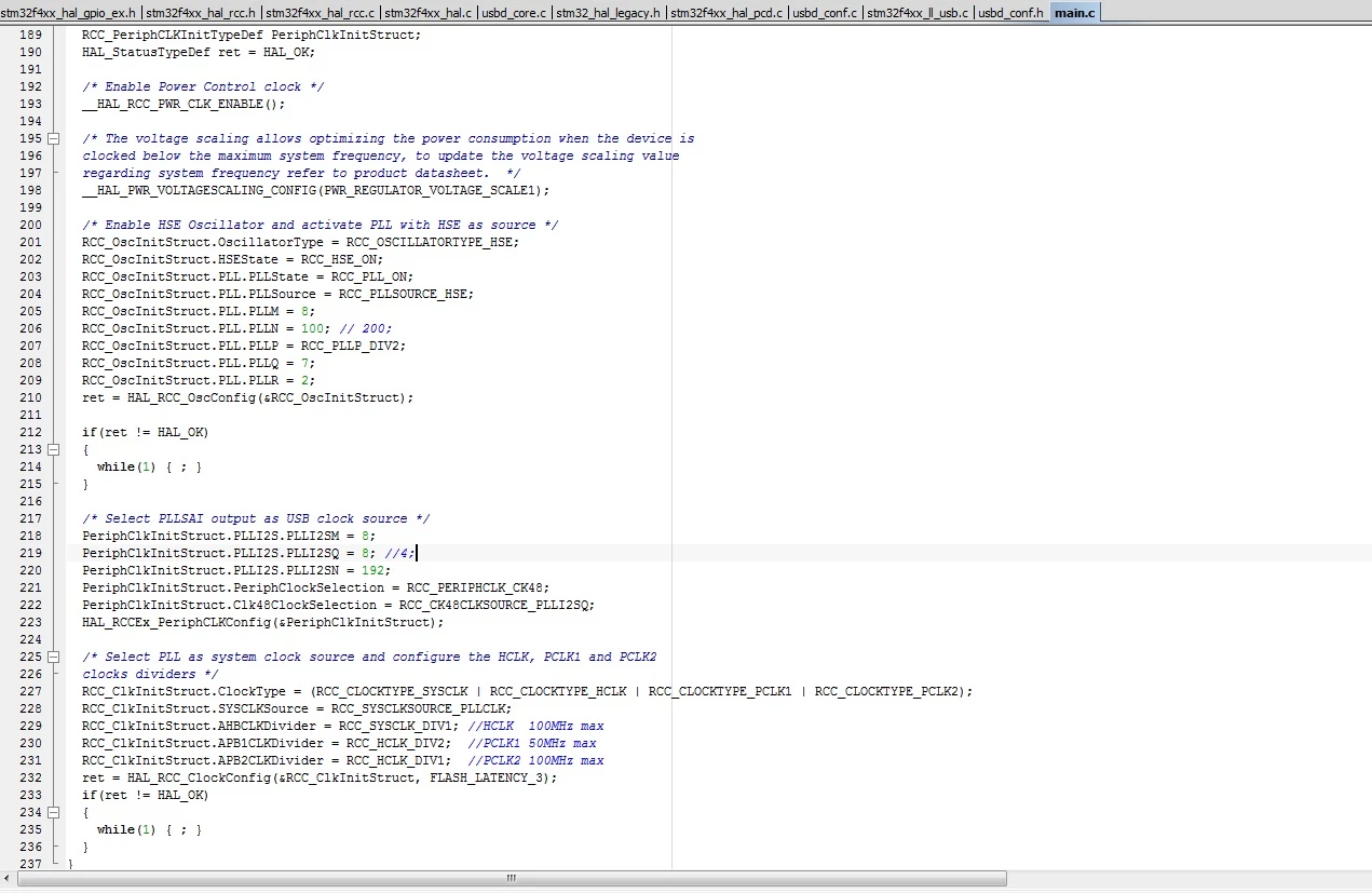

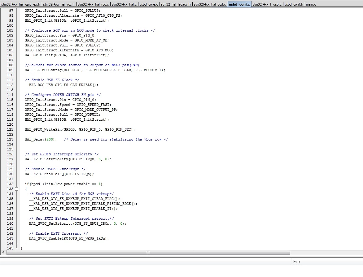

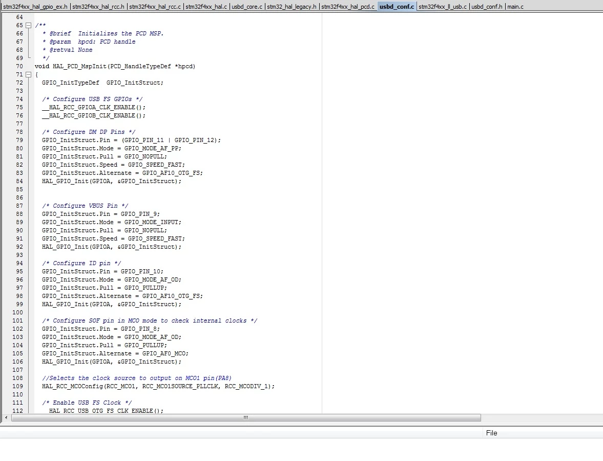

    Please find the code images with PLL clock configuration, USB pin configuration and the hardware design.
    These are the only changes I've made to the example code available at above link.

    The numbers I see here seem okay as far as NUMBER MATH. Make sure that these numbers are within the range of acceptable numbers for your specific part for each setting. I am pretty sure I've seen complaints of CubeMX generating numbers that were GOOD NUMBERS generally but BAD numbers for specific part capabilities.
    Don't know if that's been fixed. Try a few combinations that are within the spec but *other* than THESE numbers and see if that helps. Just so long as your math lands on 48Mhz. According to the TREE in the UM your okay with 16Mhz,  /8 (/2 to /63) , *192 (50 to 432) , /8 (2 to 15)
    You must be doing SOMETHING because your VBUS detect must be working and yanking up the D+ (or D-) line since your analyzer saw traffic from PC to device. (PC knows you plugged SOMETHING on)
    Um.... Make sure it is yanking up the D+ line for FS and that you don't have the D- getting yanked up by a line swap, which puts the bus speed off in the weeds....

    How about trying System Memory Boot Mode (BOOT0 high) and seeing if the PC recognizes the ST DFU Bootloader? This should tell you if your hardware is working.

    And if that doesn't work right, the way things are around here with purchasing, receiving, inspection, kitting, assembing interactions, you might want to make sure R9 and 10 are REALLY the values that you REALLY wanted.
    Also you might want to make sure R9 and 10 are really needed for this part. Variation of ST devices sort of mingle in and out of that need. Some are BUILT IN.
