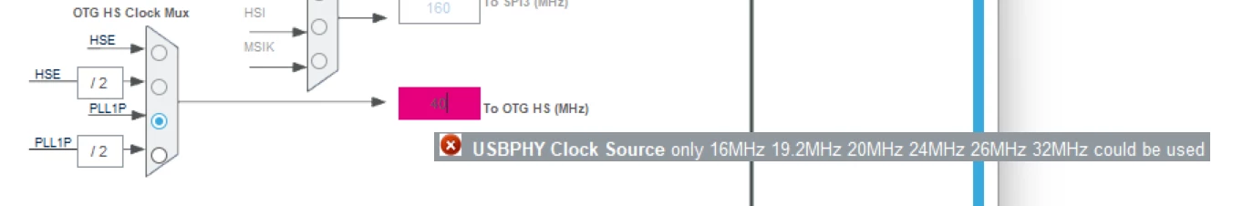

In RM0456 section 73.4.3 OTG_HS core (p.3279) I found the following statement:
"The OTG_HS receives the 60 MHz clock from the reset and clock controller (RCC). This is typically generated in the PLL associated with the HS PHY and enabled in the RCC. This clock is used for driving the 60 MHz domain at high-speed (480 Mbit/s) and must be enabled prior to configuring the OTG core."

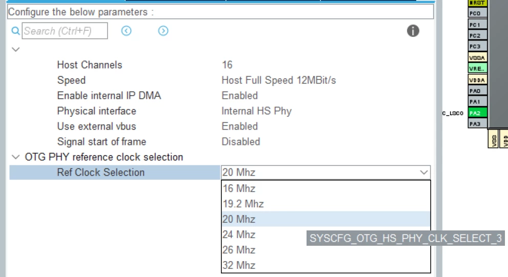

I try to configure STM32U5A9 MCU with CubeMX, but I find no option to configure USB 60MHz clock.
The only available clock setting called "OTG HS Clock" cannot be set to a value larger 32HMz and probably needs to match setting under "Pinout & Configuration" where this time it is called "Ref Clock selection" - see screenshots below.
Where do I set 60MHz clock as described in RM0456? Instead, CubeMX offers 16/19.2/20/24/26/32MHz clock selection. In RM0456 I found no 16/19.2/20/24/26/32MHz clock values mentioned.
Please advise. I am a bit confused.
