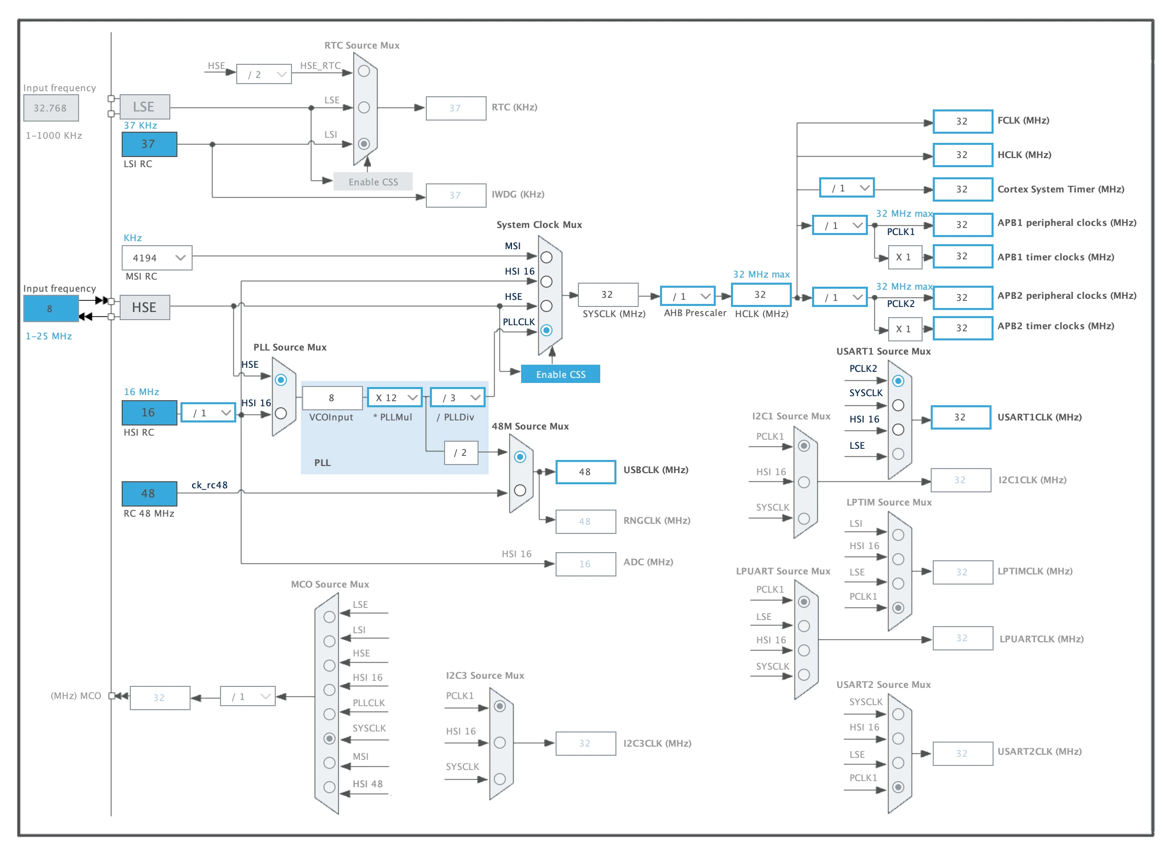

Thank you for sharing ! Indeed your hypothesis seems interesting on  right clocks between different blocks - USB, System , APB1 and APB2  :
If possible to let us know your Clocks settings ?
Thanks again.
STOne-32.
DelaneyAuthor
August 6, 2024
Thank you for the reply.
Here are my clock settings:

STOne-32
August 6, 2024
Dear @Delaney ,
Thanks for sharing,  may be this sentence is key "If I set USART4 to 31250 baud, USB does not work (enumeration fails)" How USB enumeration can fail due to USART4 baud rate at 31250 instead of 115200  ?
may be to check how the MIDI Class and example is setup at application level and clocks synchronization.   Very interesting case.
STOne-32.
