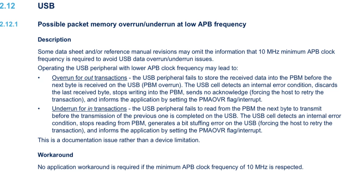

STOne-32
July 18, 2024
Hi @PGump.1 ,
Can you please try to change the USB port on Your PC connected to the board and if you have a full speed HUB to try to put it in between and try again . I have suspected hypothesis the following, check the minimum APB frequency that is  16MHz .
F0 runs at 48MHz and L0 at 32MHz this may impact the migration and processing of the transactions speed .
let us know .

PGump.1
PGump.1Author
Senior II
July 19, 2024
Thanks for the reply.
I had read the Errata notes. I did see that. Initially my APB frequency was 16MHz, I changed it to 32MHz to see if that was the problem, but it made no difference.
I had tried it directly to PC ports, through Hubs, Windows and Linux...
Linux lists it with 'lsusb' command, but PuTTY won't connect to it.
Windows states the driver for the device did not install correctly or, Unknown device.
I have built up a second board - it's doing the same thing...
I have removed the USBLC6-2SC6 on one of the boards, it's still not working.
Any other clues?
