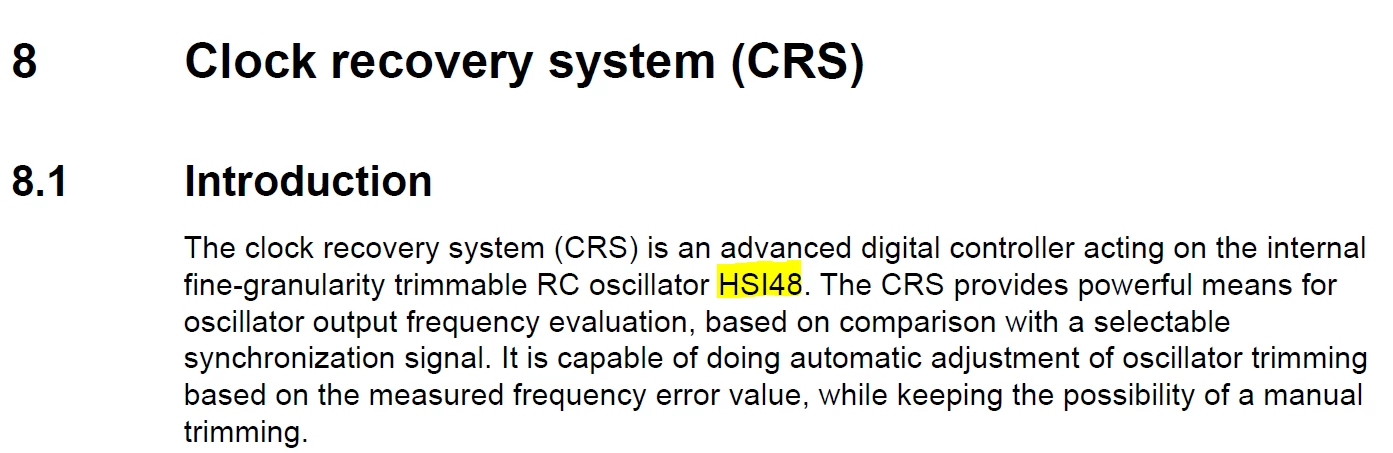

As stated in the reference manual, crystal-less USB requires you to use the HSI48 clock. On the CubeMX clock select screen, this is the "RC 48 MHz" clock.

> Is there any option to drive USB using HSI_RC ?
Yes, the STM32L0x2 series supports crystal-less USB. Look at the Clock Recovery System in the reference manual.

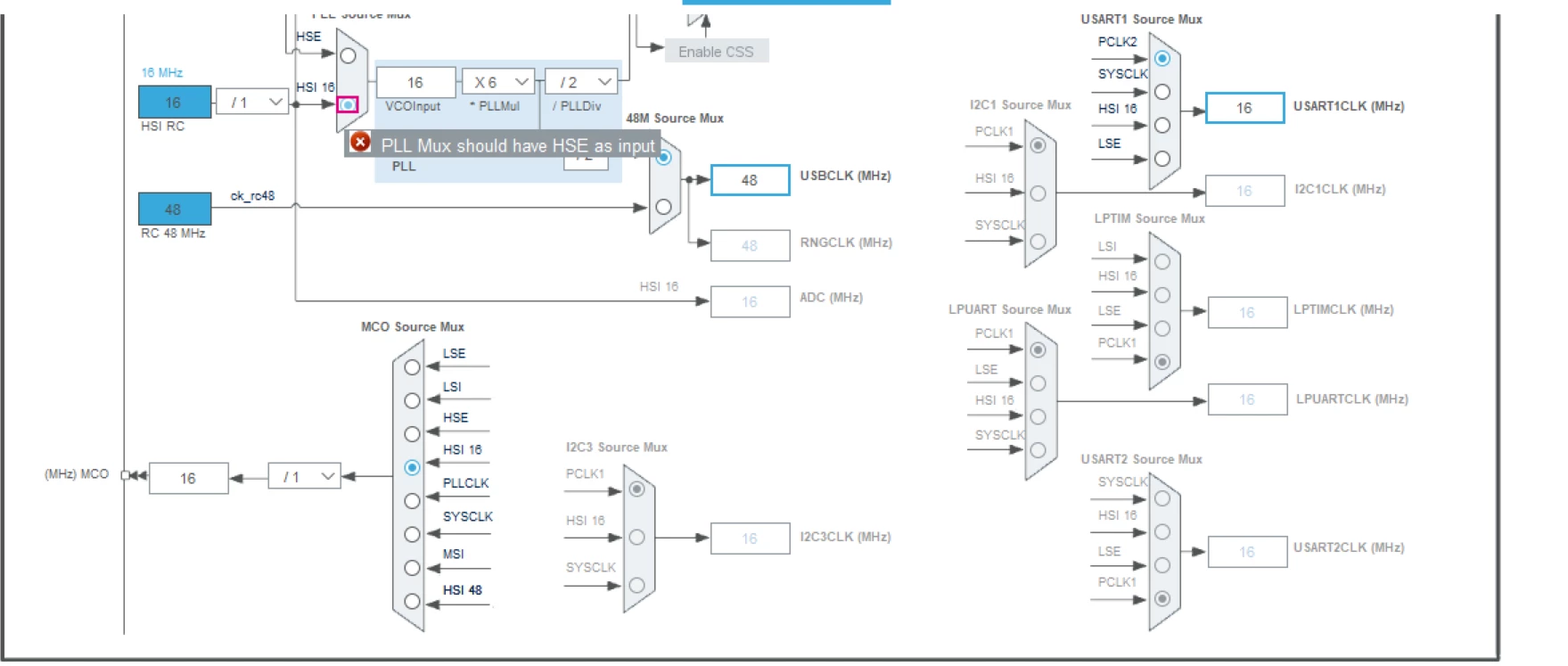

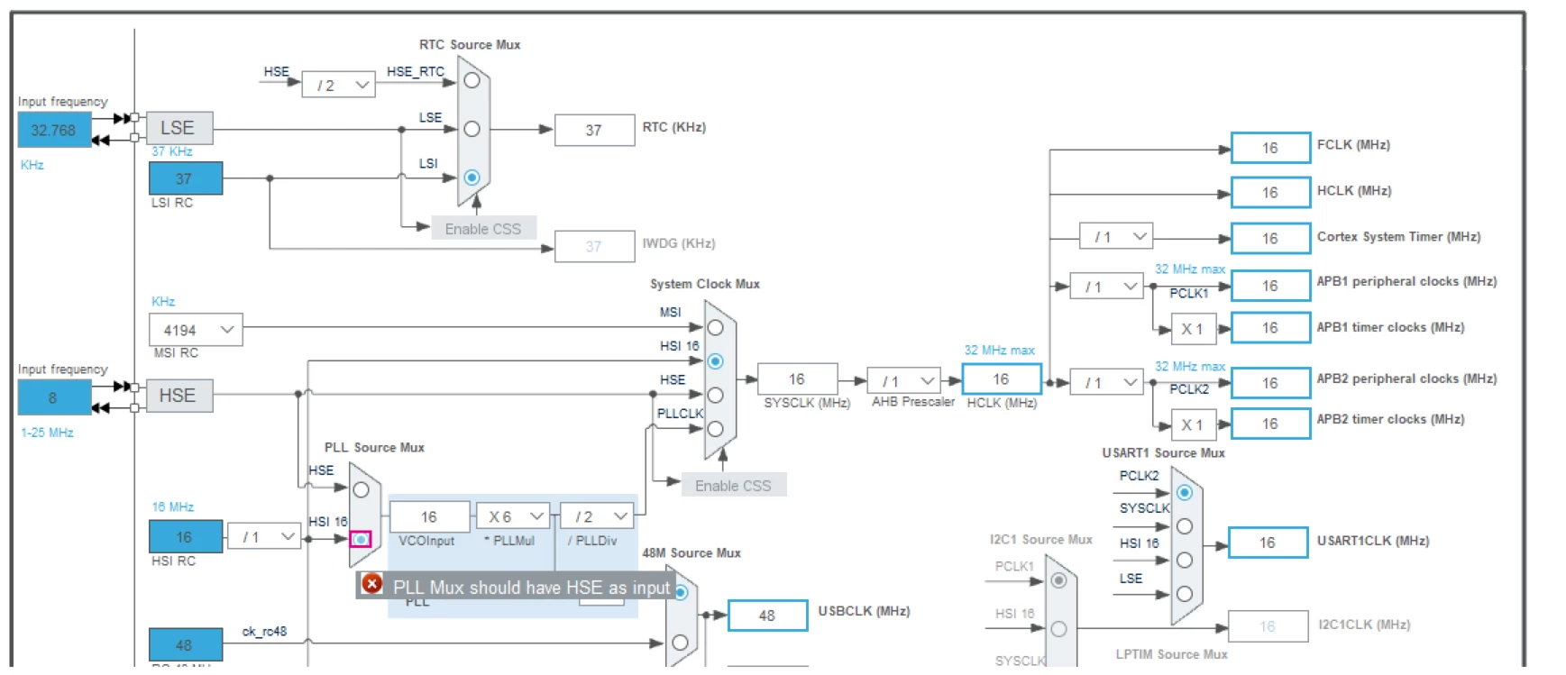

My issue is not solved. Please check the attached images of CUBEMX CLOCK Configuration.

Attach your IOC.

Aug 31, 2023 2:24 PM UTC
