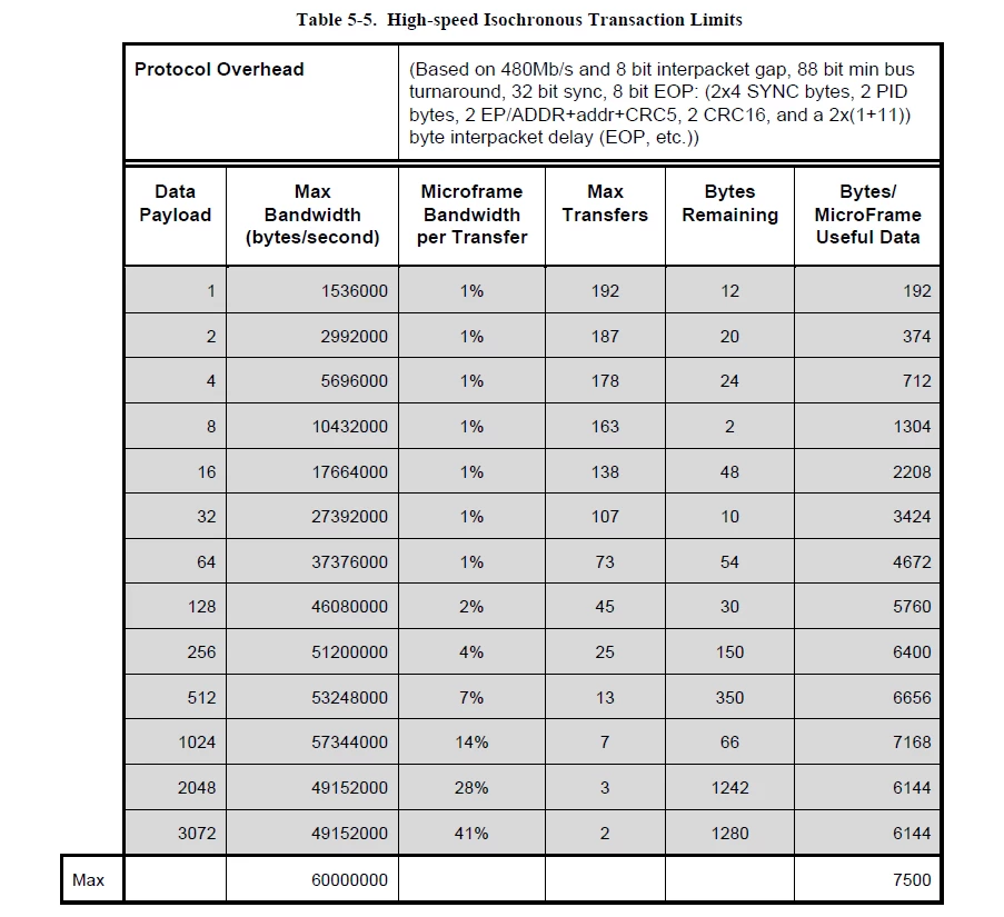

Just a question, @Mohamed_AYED  ,
>with 1024 bytes for each 1,25us
is 6,5 Gbit --- isnt hi speed usb 480M clock ?  so how to get 6G on this ? or you talk about USB3.1 at 10Gbps ?
Explorer
May 19, 2024

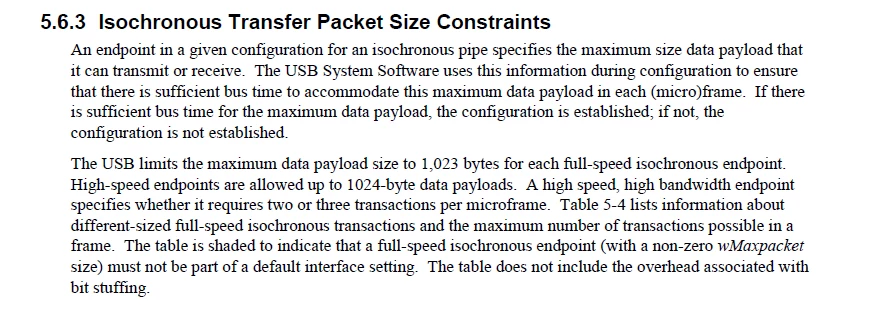

@AScha.3
Refering to USB2.0, max packet size in HS mode is up to 1024 byte.
If you see Table 5-5. High-speed Isochronous Transaction Limits:
