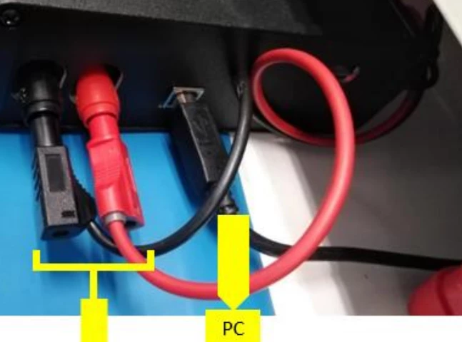

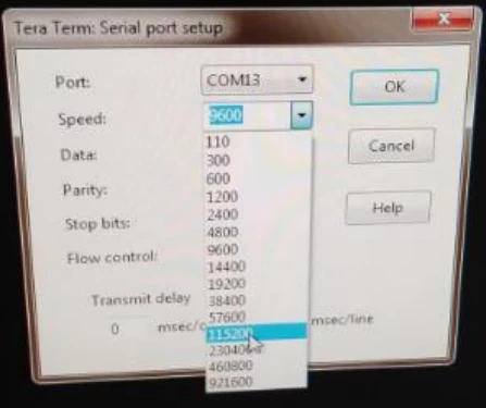

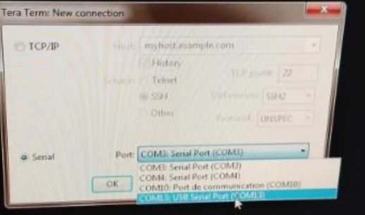

In my graduation project, I'm utilizing the STM32H735_DK microcontroller to communicate with a GMSL (Generalized Memory Scalable Logic) device. Typically, these devices are configured using terminal programs like Putty or TeraTerm. Commands, such as "PICT START," are sent via a USB A to USB B cable from a PC to the GMSL.
Despite my attempts to replicate this communication using UART and USB CDC with the STM32, I've encountered difficulties. Conversely, my friend successfully communicated with a GMSL device using a Raspberry Pi via a serial port.
I'm unsure how to resolve these issues and would appreciate any assistance. Thank you!

You need to provide details on how you establish communication between the GMSL device and at least using your raspberry? Attach the datasheet of GMSIL device. Unfortunately, pictures attached does not explain your hardware setup. Knowing the connector cannot allow us to predict the protocol used.
