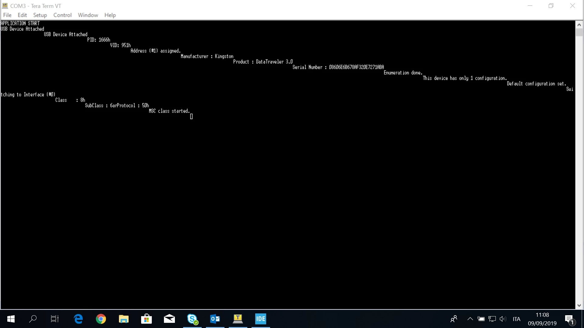

Hi all,
i succesfully tested USB HOST drivers in standalone mode on a Nucleo-F746ZG.

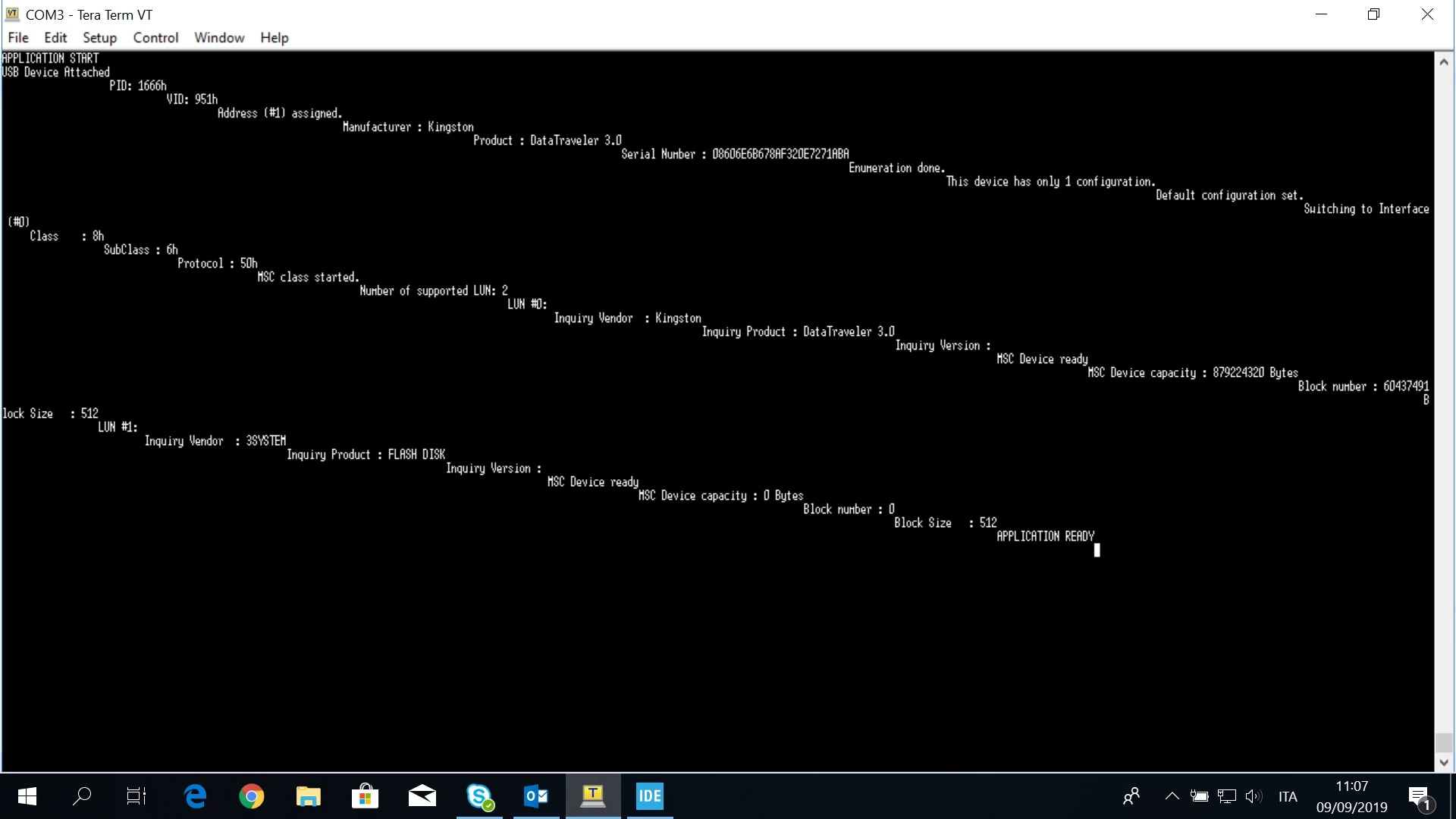

In my application i need to use CMSIS, but i can't figure out how to make it work. I am using the same application that i use on the standalone mode but this time i placed it in a thread. I've also tried to use 2 different threads for initialization and the user application. It recognizes the USB drive but it never goes on the state ready. This is due to a status USbH that never goes to OK and stays BUSY.
    1 reply
    AGaru
    AGaruAuthor
    September 9, 2019
    Defining USBH_DEBUG_LEVEL   1U i obatined the following debug prints:
    2)Not working case with CMSIS
