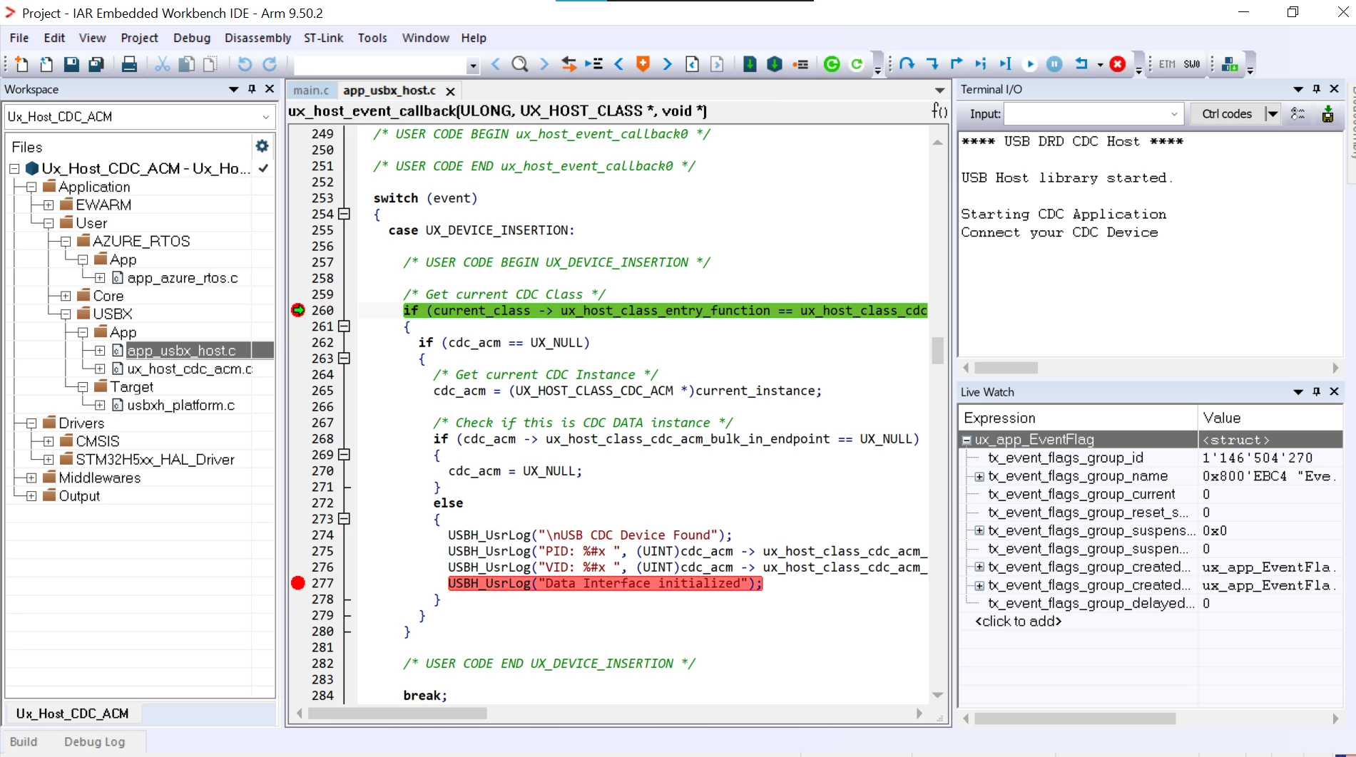

Hi @Mohan30
Which board are you using? I suggest you following the workshop on H5 STM32H5 workshop - 09 USB - USBX-CDC lab (experts) (youtube.com) If using Nucleo-H503, USB Host configuration is not recommended because it is not USB-C® compliant.
However, if you would you like to use it for testing purposes you should set the following solder bridges :
  •  SB1 and SB7 ON
  • SB14 ON
  • SB4 and SB8 OFF
To give better visibility on the answered topics, please click on "Best answer" on the reply which solved your issue or answered your question.Best regards,FBL

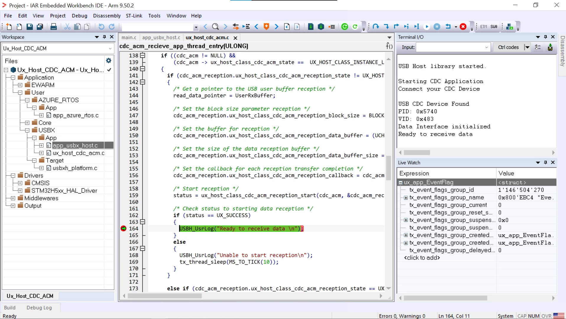

FBLBest answer
October 1, 2024
You are welcome @Mohan30
If you need example for device STM32CubeH5/Projects/NUCLEO-H503RB/Applications/USBX/Ux_Device_CDC_ACM at main · STMicroelectronics/STM32CubeH5 (github.com)
For host mode, I can share with you this example
