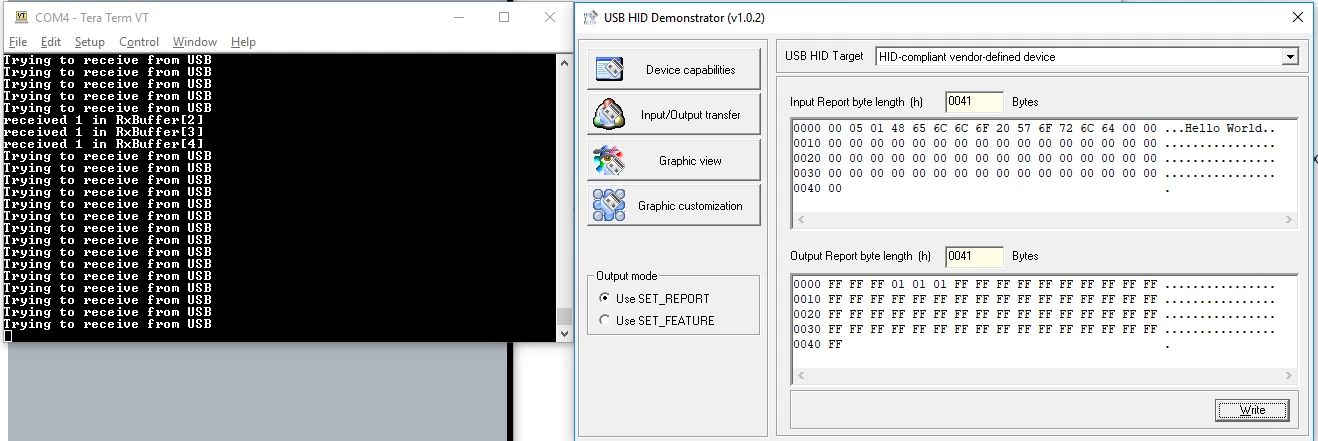

    0690X000006Buf0QAC.pngSo I was able to get somewhere with the USB Hid Demonstrator from ST. I actually found a different example that was on YouTube and modified it to transmit and receive via Custom USB HID. Attached is the source that I had working in. I was using a STM32F401 via a Nucleo-F401RE board and my code was done in System Workbench for STM32.

    Attached is a screenshot of a terminal application and also the USB Hid Demonstrator application. In the input/output transfer, you can see the input and output reports. The demo code is just sending the message "Hello World" plus a count over and over. It is possible to send information into the board using the Output Report. For demo purposes, you can manually modify the bytes then click on the Write button to perform a USB communication with the bytes in the Output Report window.
    From the terminal, screenshot it shows:
    received "1" in buffer[2]
    received "1" in buffer[3],
    received "1" in buffer[4],
    I used this as the basis of building the different functions by sending different bytes into the devices and then performing different operations.
