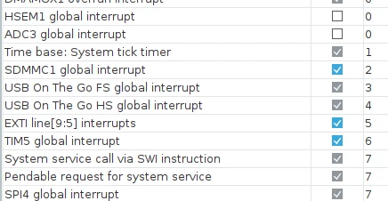

i have the MX_USB_HOST_Process() at the end of main while-loop, is called about at 200us interval, when nothing else happens. but maybe also 120ms HAL-delay comes, for delay after keypress, no problem with USB.
i use usb-MSC host, connect to usb-stick, reading data for constant data rate at about 1.6 Mbit . the FAT data read is in interrupt , so no problem.
important is INT priority ... :)
usb is highest of other int , see:
