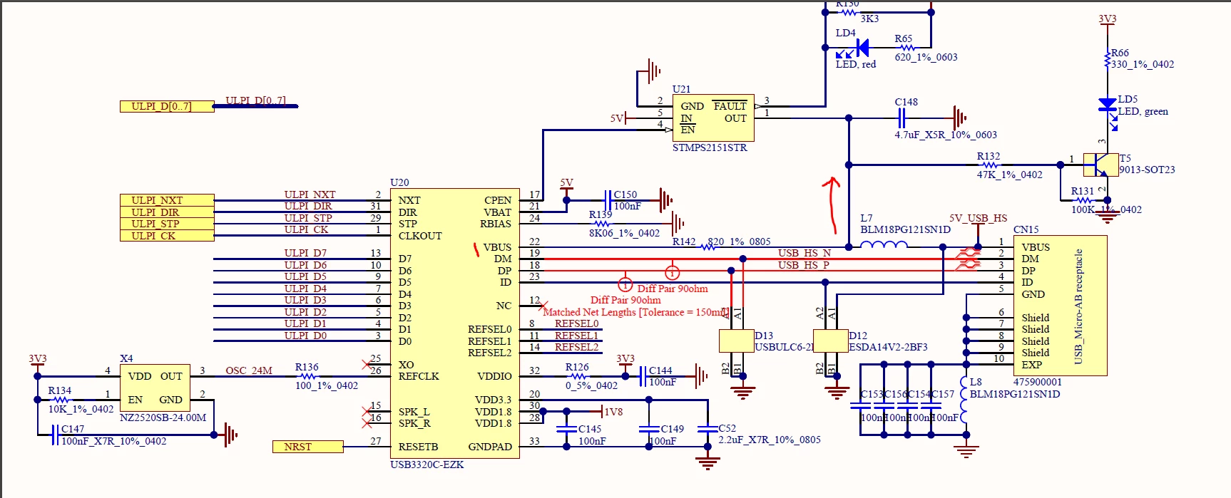

I am working on OTG FS application on stm32f769 discovery board, as per the it's schematic for OTG_FS VBUS power supply will be taken care by External Phy(see below image).
So as per that I configure the STMCUBE IDE, and i disabled the VBUS_Sensing also. and started the debug process. I noticed that it is getting failed. Inside this USBH_Process in 1st switch case i.e. HOST_IDLE case there is one if condition, that is getting failed.

 Is it related to VBUS ? even i tried by enabling Vbus_Sensing and kept the PA9 gpio which enabled automatically after enabling VBUS sensing still same issue. Can anybody tell me anything am missing here.

Hello @Shikamaru
USB power switch is connected to VBUS and provides power to CN15 when stm32f769 is Host. However, VBUS is powered by another USB host when F769 is device.
Would you please share the state of jumper usbhs in CN3?

Jumper on CN3 is connected to stlink.

Hello @Shikamaru
You should connect the jumper usbhs in CN3. It is necessary for ULPI interface
In datasheet section Driving External Vbus, CPEN is dedicated to controlling the Vbus supply when configured as an A-Device (host).
It is mentioned in the user manual, 32F769IDISCOVERY Discovery board must be powered by an external power supply when using the host function.
