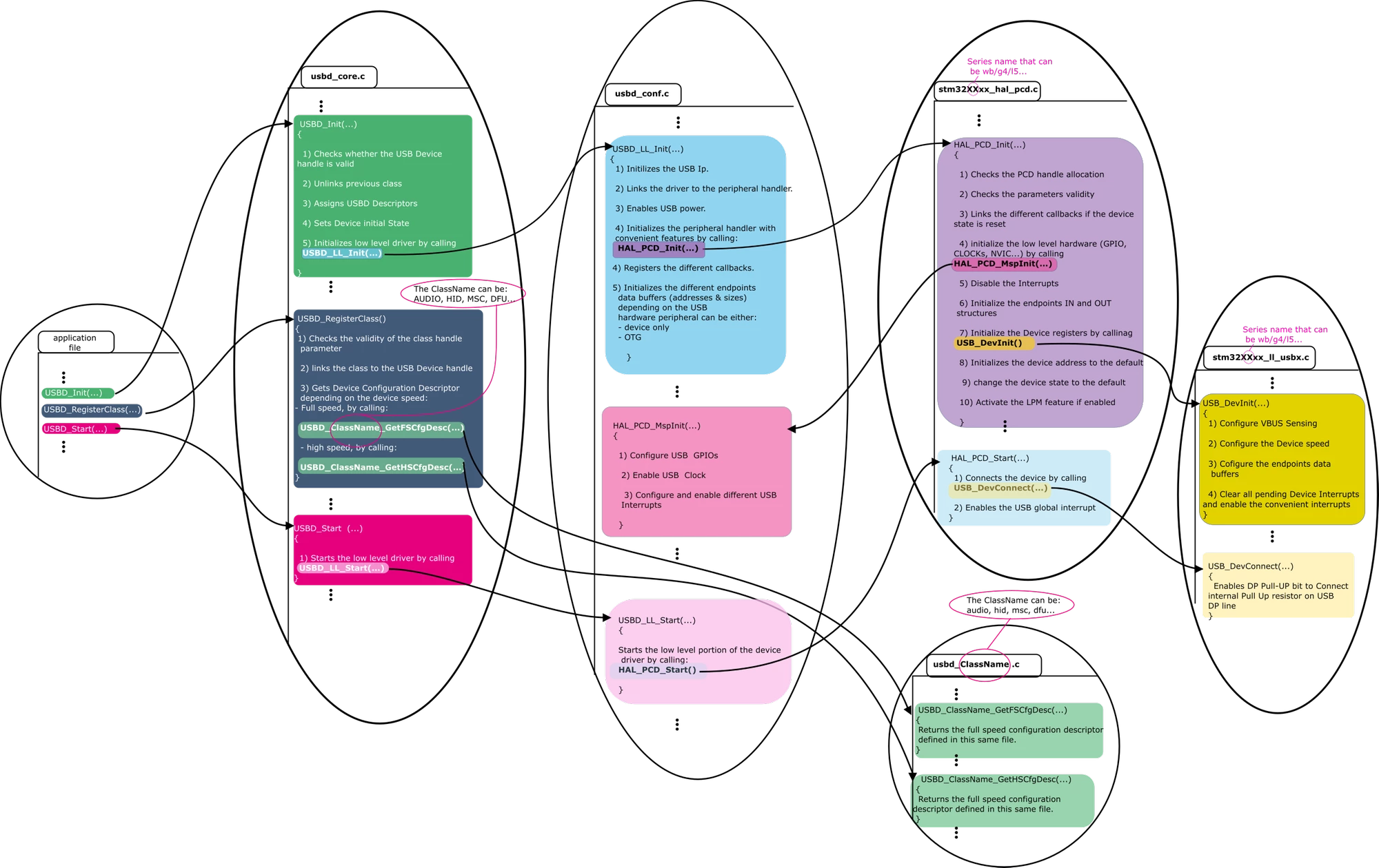

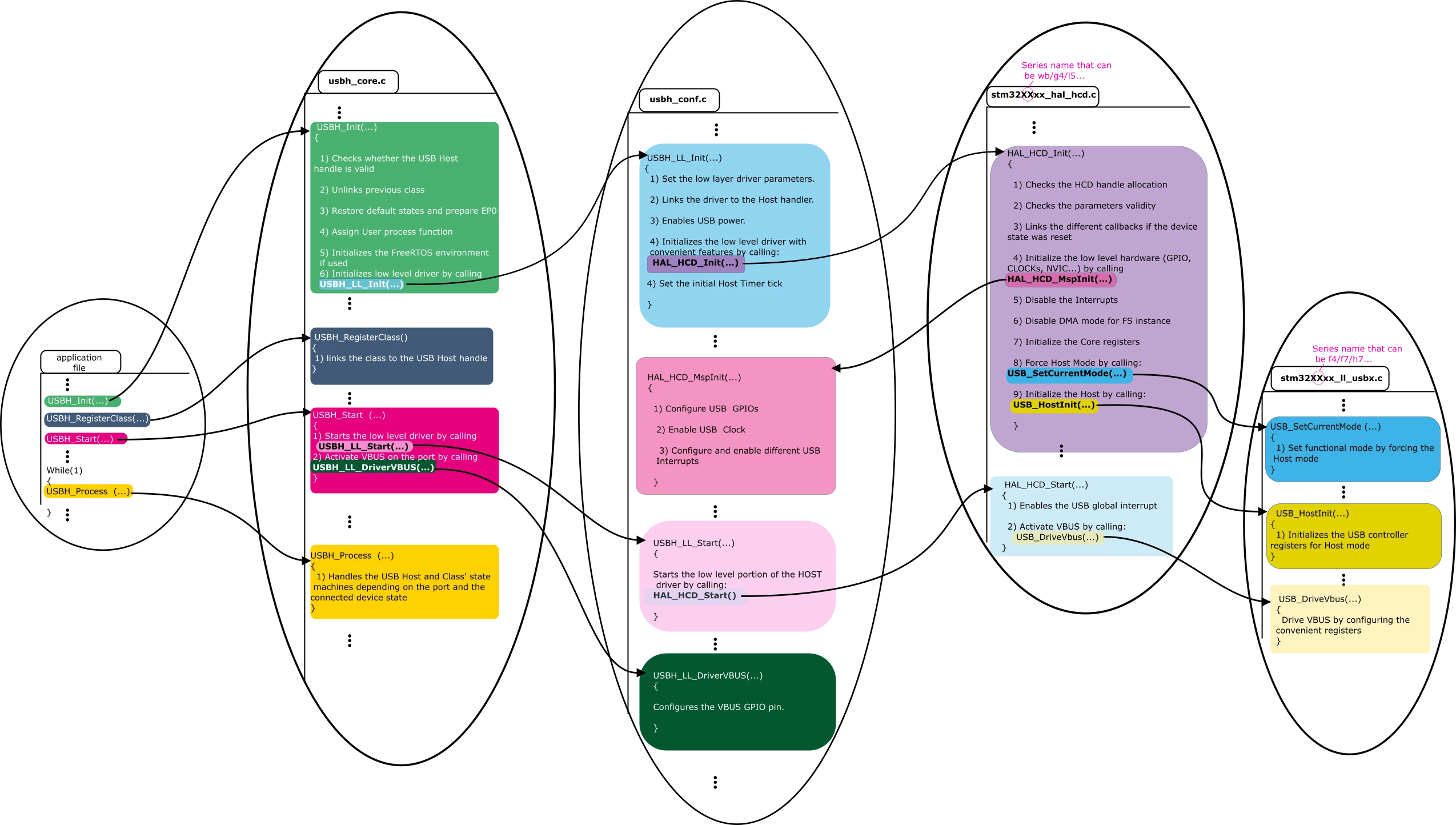

Now, the implementation of ST USB library,
usbd_core and usbh_core files include the implementation of the core state machine process and the enumeration and the control transfers processing.
usbd_ctlreq and usbh_ctlreq files include the implementation of the processing of the control requests required for the device enumeration.
usbh_ioreq and usbd_ioreq files include the implementation of different USB transactions process.
In host mode:
In device mode:
USB stack ensures the correct reception and decoding of the host request and then device state modification accordingly. For further details I suggest you this interesting WIKI

Hi @krn
First, the interpretation depends on the product family in question. Messages are fully described in USB specification. The process to enumerate USB device is as follows.
  1. The process begins with the detection of a new USB device.
  2. The host detects the connection of the USB device.
  3. Then issues a reset signal to the device.
  4. The device responds by indicating its speed.
  5. The host requests the device descriptor from the device.
  6. Then checks if the device descriptor is correct.
    • If yes, the process continues.
    • If no, the enumeration fails.
  7. Now, Host assigns a unique address to the device.
  8. Host requests the configuration descriptor from the device.
  9. Host checks if the configuration descriptor is correct.
  10. Finally, the host sets the device configuration. The device enters its fully operational state, and the enumeration process is successful.
In host mode:
In device mode:
