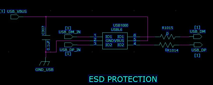

Jul 2, 2025 2:16 PM UTC
Hello FBL,
Hardware design docs into STM32_USB_training_Content.zip - Google Drive
Suggests to use USBLC6-4SC6 instead USBLC6-2  for Self Powered Board , However , I could not retrieve the Reason...
May be because 4 Line Protection ( along with ID Pin )..
However , I used USBLC6-2 for D+/D- Line.
I have not used any separate ESD for VBUS line from the Host. I just connected it VBUS of USBLC6-2. ( See Schematic)
Await your valuable comments on that.
Jul 2, 2025 4:13 PM UTC
Hi @bsuthar
We have two different implementations on different boards F303 eval board (MB1019) and F446 eval board  (MB1162)
To give better visibility on the answered topics, please click on "Best answer" on the reply which solved your issue or answered your question.Best regards,FBL
