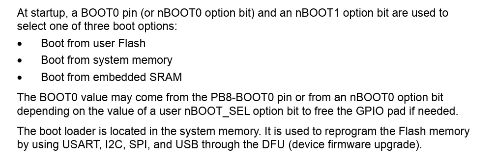

> Does the bootloader recognize if there is USB connected automatically?
If pin boot0 is hi at start/reset , bootloader tries all possible inputs (see rm ).
If boot0 lo  , flash/user program is started.
So set pin PB8 with a pullup to VDD hi , seems on the board is no pullup.
Or use a jumper cable from JP7 to VDD on the pin header for boot0 .

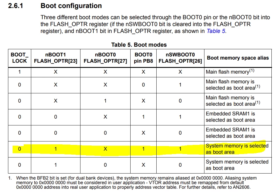

March 18, 2024
You're not in the mode that you highlighted. You want nSWBOOT0=0.
with nSWBOOT0=1 and BOOT0=0, you are booting to main flash (regardless of nBOOT0 and nBOOT1 settings).
Yes, it will auto detect and connect.

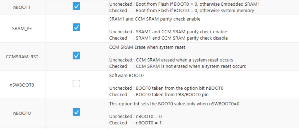

March 18, 2024
Here is the configuration I'm using now, but same result:
To make it more clear JP7 is connecting the BOOT.
