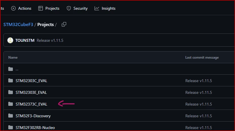

bsutharAuthor
Sep 25, 2025 12:07 PM UTC
Thank you, FBL
For this Suggestion. I will Look into it.
By the way , you Suggested to use DFU of  STM32373C_EVAL  , Would it better to use DFU of STM32303C_EVAL "OR"  STM32F3-Discovery ? Considering my Device : STM32F303rb.
Also , if you can Confirm these DFU example resembles to this Training Session : https://www.youtube.com/watch?v=n_LDXOQHerU
Thanks.
