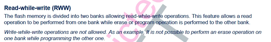

Please check your reference manual for the flash chapter. Generally we do not support write-while-read function for flash, so you need to use IAP(bootloader) to program the internal flash

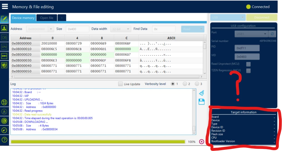

To give you the global context :
My objective is to use the usb port in Virtual COM mode, and to go in DFU mode with a specific command on the this virtual port.
My firmware is running good, i send a specific command and is going in DFU mode, i can read that's nice, but i can't erase and write ( i juste can read )

i don't resolve my problem :(
I think the problem is : i doesn't have CPU information loaded in dfu mod (see picture )
October 27, 2023
What's the problem? Looks like DFU is running fine.
November 2, 2023
Do you know how I can use the bootloader to update in USB mod ?
