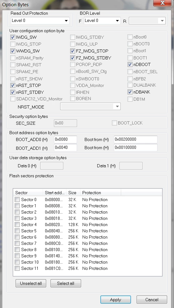

Reading the options bytes, which should be fine, I got:
Could you please suggest a workaround to overcome the USB enumeration problem? probably I am missed something?

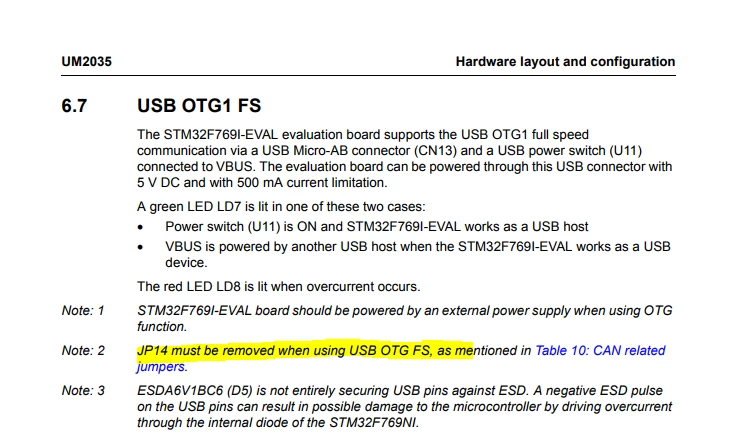

    Removing the jumper JP14 and solved the issue.
    JP14 when connected will make PA11 connected to both CAN1_RX and USB_FS1_DM. Even if CAN bus is not driven this will lead into failure on USB communications.

    yes in fact  JP14 must be removed when using USB OTG FS.
    -Nesrine-

    Indeed I overlooked that instruction.
    I think it's worth it to mention that information or refer to the USB OTG FS chapter in the boot configuration section.
