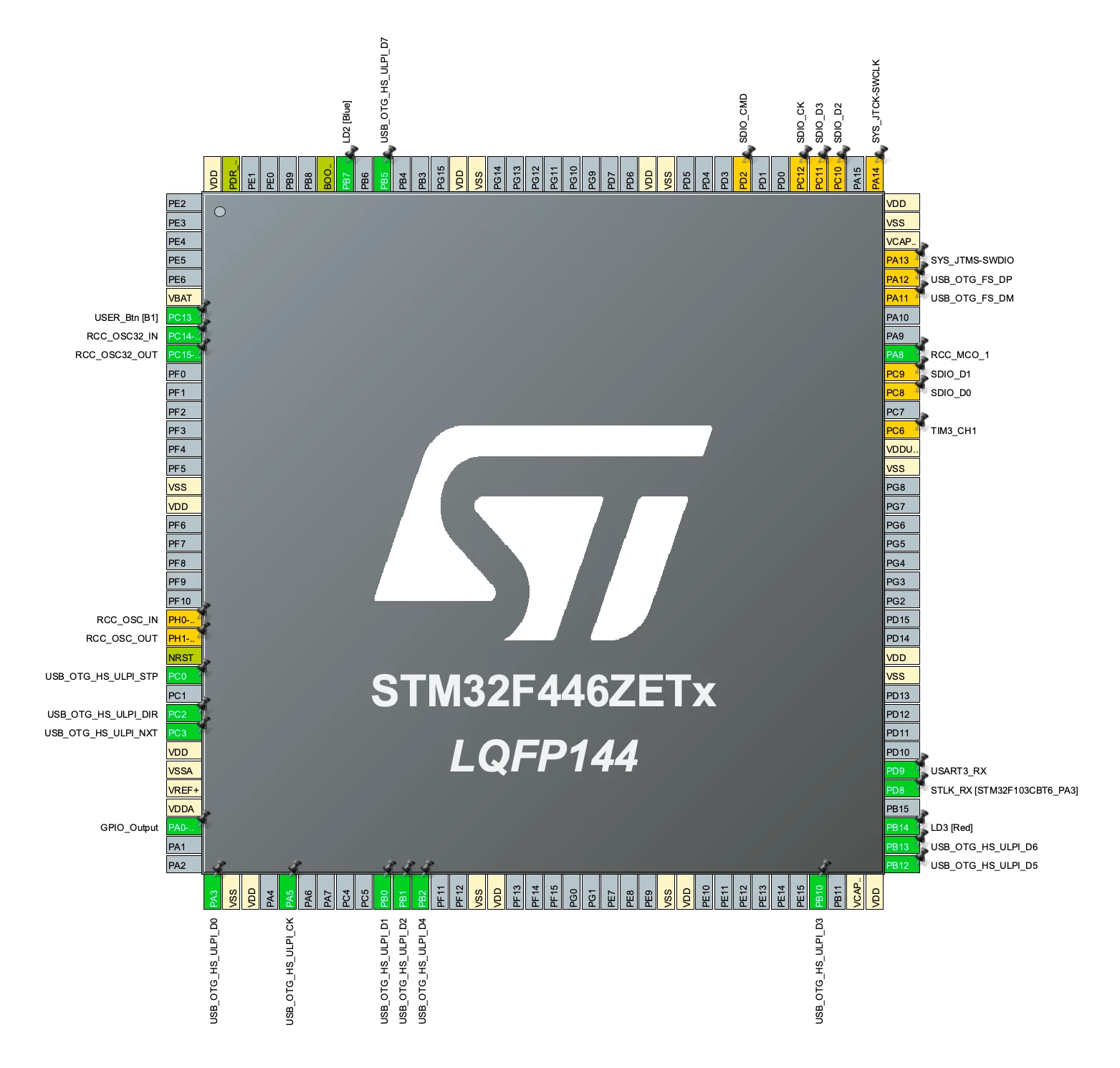

I am working with an STM32 development board and an external PHY (USB3300) to establish communication using USB High Speed. However, the USB is not being recognized, and I would greatly appreciate any advice or guidance on how to resolve this issue. Thank you in advance for your help.

I have connected the devices as shown below, but when I check the Device Manager on my PC, the USB device is not recognized.
My Guess at the Cause
Could it be because PA11 and PA12 are connected to STLINK-USB_DM and STLINK-USB_DP?

Steps Taken
Created a project using STM32CubeIDE
Configured the pins in the pinout view (see image linked below)
Set USB_OTG_HS to "External PHY" and "Device_Only" under Connectivity, and enabled the USB On The Go HS Global interrupt in NVIC Settings
Set the Class for HS IP to "CDC" under Middleware and Software Packs
Wrote the code for main.c (see below URL)
https://drive.google.com/file/d/1854QExJgEYuRdi5xYT4wJ6Gb2AY0DqzF/view?usp=sharing

    So you expect a 480Mbit connection and PHY working on a jumper wire connection and a breadboard ?
    Very naive , i think.

    I have no such experience. Could the use of jumper wires and a breadboard cause the device to show up as 'Unknown USB Device (Device Descriptor Request Failed)'?
    I am thinking of creating a shield to connect the development board and PHY using a universal PCB.

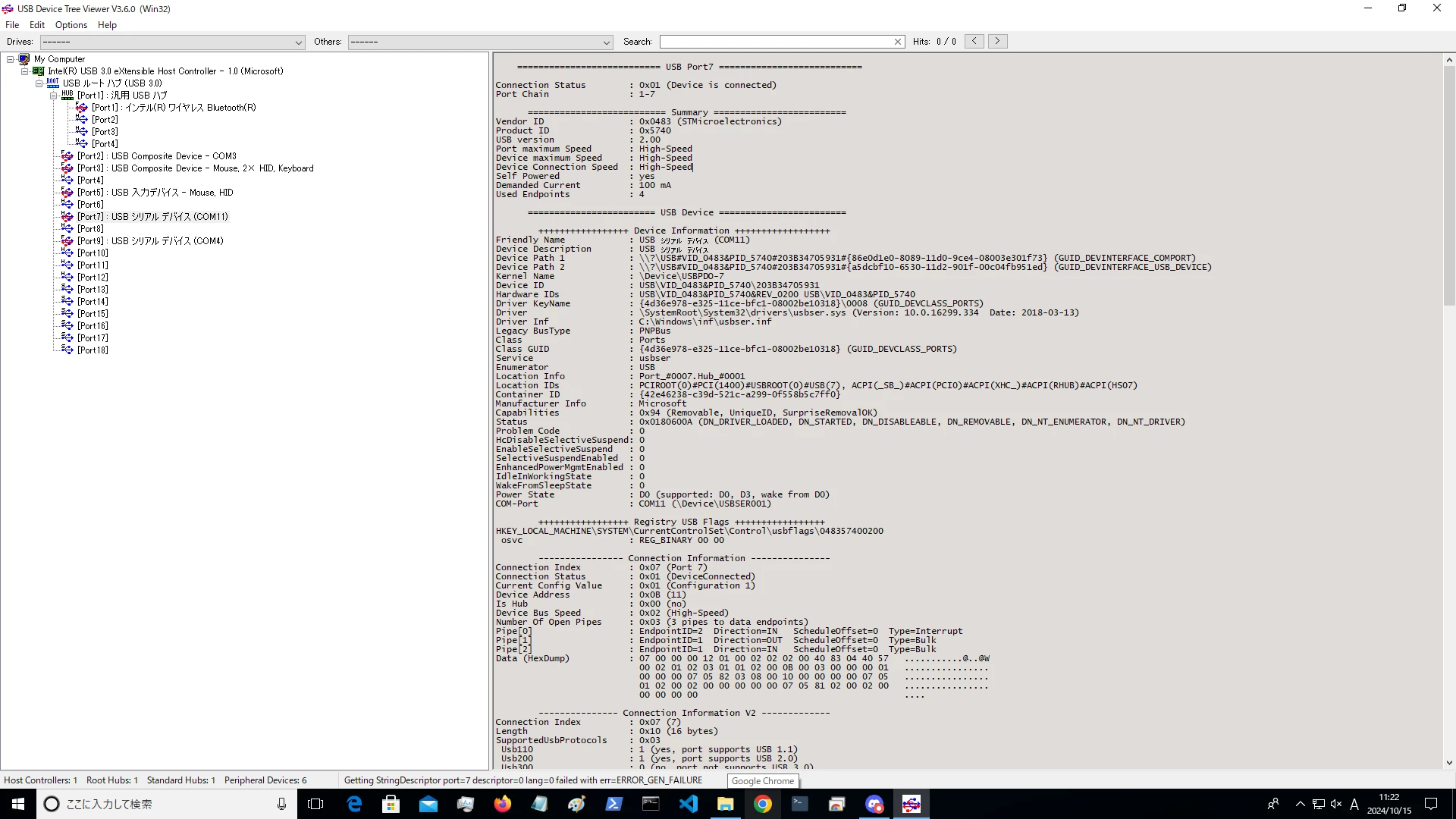

    HyattAuthor
    October 15, 2024
    @Richard Li
    Thanks for the help!
    I tried changing the cable(support usb2.0, U2C-MF50BK), but result was the same .
    I think it is probably recognized in HS because USB Device Tree Viewer show high speed.
    USB Device Tree Viewer: https://drive.google.com/file/d/1VMC-ssH2HegwjDNyY9PAutBeFFSj1LSf/view?usp=sharingusb.png
     ========================== Summary =========================
    Vendor ID : 0x0483 (STMicroelectronics)
    Product ID : 0x5740
    USB version : 2.00
    Port maximum Speed : High-Speed
    Device maximum Speed : High-Speed
    Device Connection Speed : High-Speed
    Self Powered : yes
    Demanded Current : 100 mA
    Used Endpoints : 4
    Richard Li
    Senior
    October 15, 2024
    Is your device Bluetooth?
    Your USB viewer show detail is Virtuel COM port information, I guess your device in port 1, you should looking port 1 detail.
