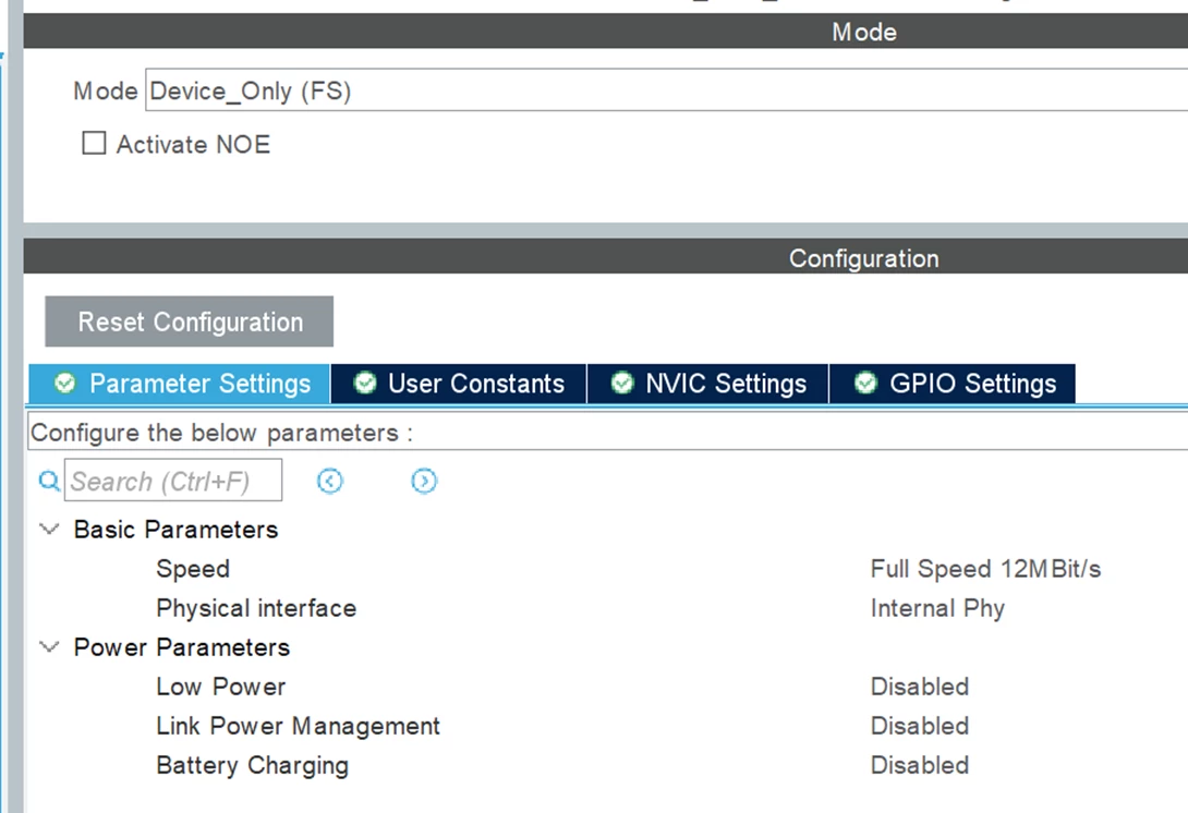

Hello everyone,
I’m trying to activate the USB module present on my custom board equipped with the STM32G0B1ME microcontroller. Currently, I would like to see data transfer from a PC serial terminal to the microcontroller. Unfortunately, this is not happening at the moment, as upon powering on the device I receive "USB device not recognized."

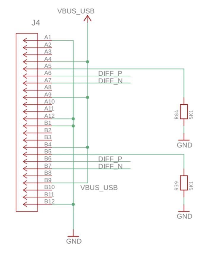

The hardware is as follows (USB Type-C):
Unfortunately, I did not design it, and I currently cannot modify it.

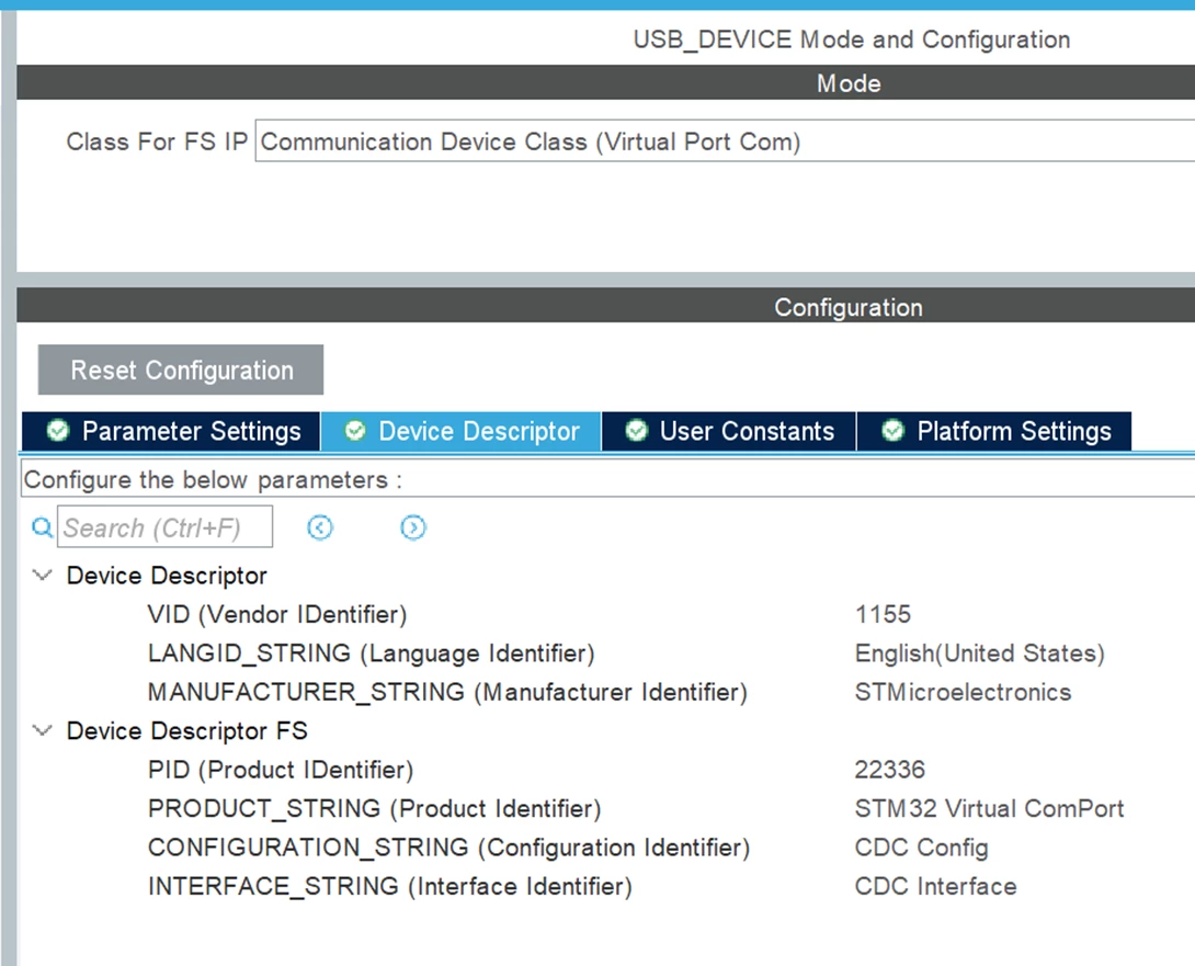

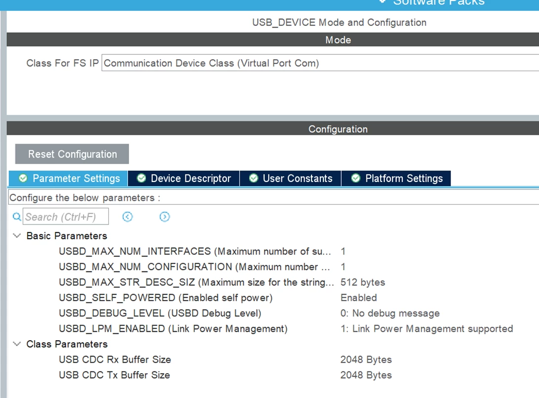

The firmware configuration is as follows:
with USB, UCPD1 and UCPD2 global interrupts enabled.
