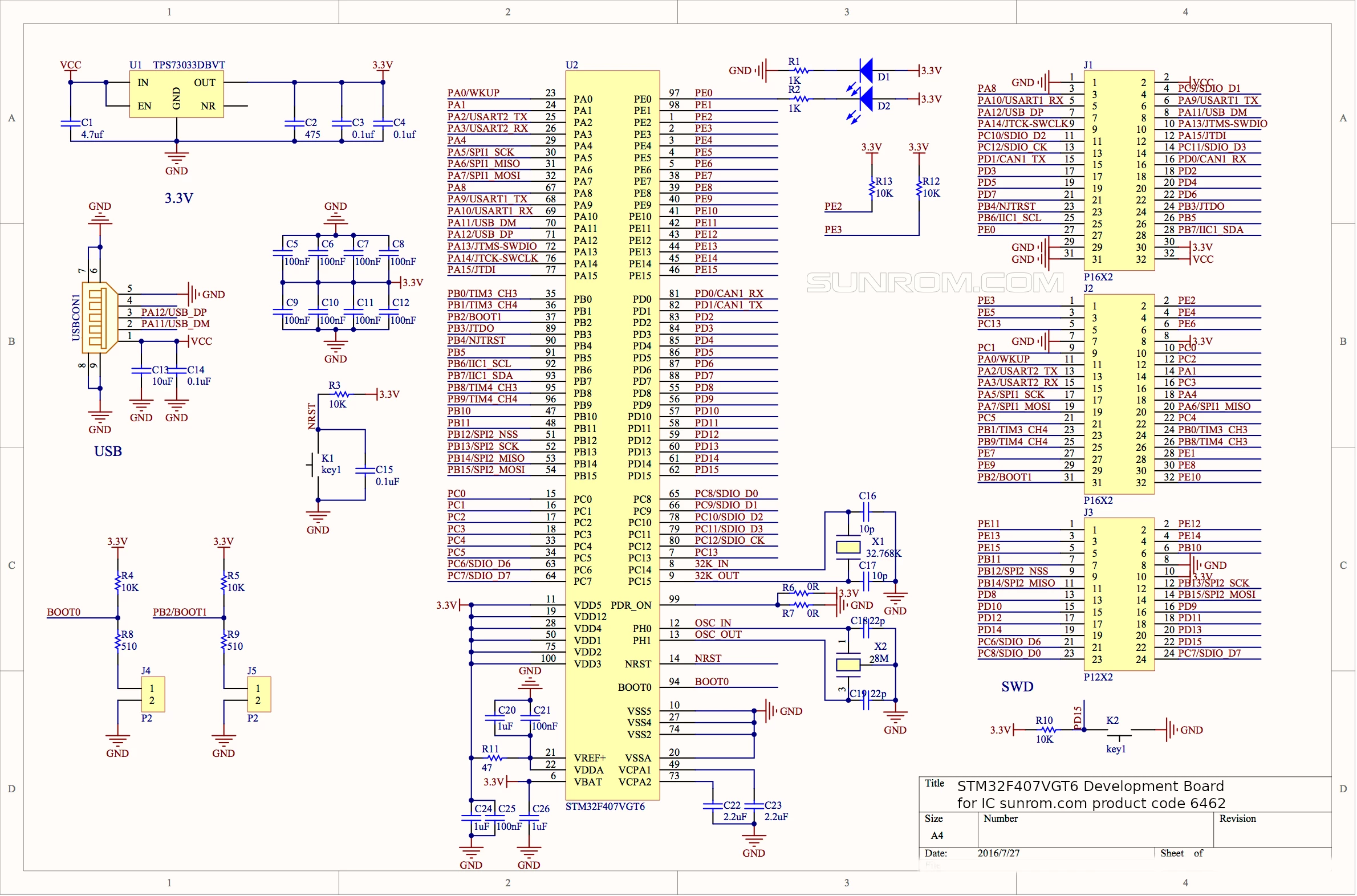

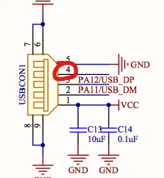

download (3).jpegdownload (2).jpeg I use stm32f407vgt6 board by DIYMORE  this is schematic. I try to make remote controller EDGETX radio transmitter.  the problem is when i pluged  usb and connect with microcontroller  desktop give warning notification  ( USB device not recognized) and check in device manager> Universal Serial Bus controllers  section showing Unkown USB device(Device descriptor request failed). try many thing and download many driver .still not work

This board has issues.
You'd be better off getting a nucleo board with a built-in programmer. Programming over the USB DFU connector is a recipe for disaster and unproductiveness.
Especially problematic:
PDR_ON shorted to both 3V3 and GND. (Pictures show both R6 and R7 are fitted.)
Also:
VDD not tied directly to VDDA.
ID pin of USB connector not tied to GND.
VCPA typo in schematic.
And my favorite, they have a typo in the silkscreen in the company name
