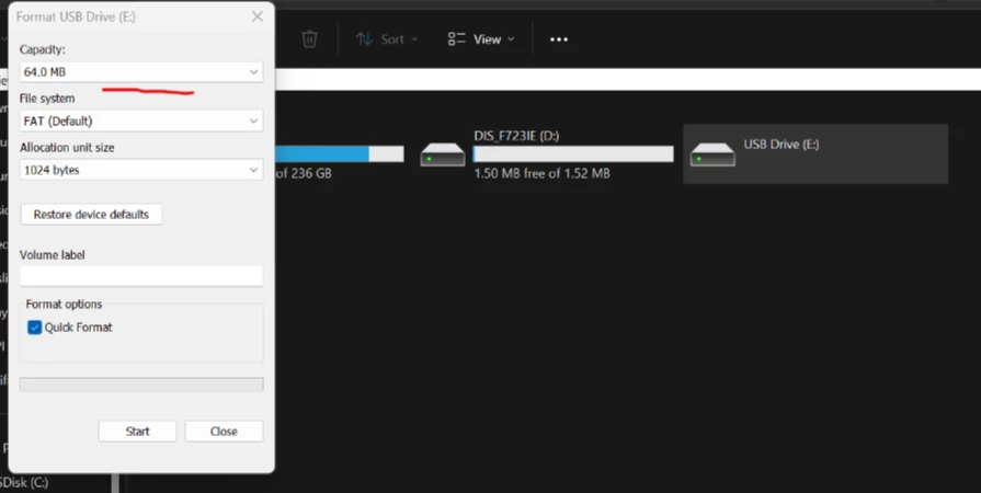

ShikamaruAuthor
June 12, 2024
Hi @tjaekel , @Tesla DeLorean ,
                     I can see my external flash in windows like below image,
before accessing it windows asks for formatting the disk. as soon as i hit format , it will hit STORAGE_Write_FS() (while debugging) this function  contains mapped QSPI  functions are there. I could see erase and write both are successful. However windows is not able to format it completely. It will through the error like "Windows was unable to format the disk". I am not getting the actual cause for the failure.
Note : FATfs is not yet enabled in firmware. I am formatting the external flash in STM Cube programmer.
