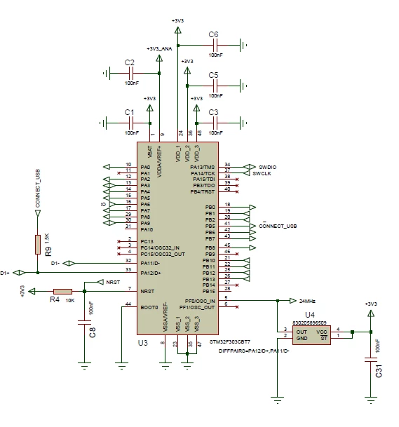

Hello everyone,
I have an stm32f303cbt6 design (see image below) connected to an hub(USB2533) and an adum for isolation, i'm trying to run a USB device CDC example by creating a new project in the Stm32CubeIDE using device tool configuration.
I selected :
- RTC : HSE Bypass clock source (24Mhz)
- SYS : Serial wire debug
- USB : fs device
- Middleware : USB device CDC
When i build and i compil to my board, windows doesn't recognise it, can you help me with that ?
(i tried also to put the connect_usb pin to 3.3 V, i got same thing)
Thanks.

I got this in USBTree (the hub has 3 downstream), it seems like the hub is detected but not the device (stm32).

It seems USB root hub does not set address to your device. You need to ensure that the STM32 and the USB hub are properly powered.
  • Verify the connections between the STM32 and the USB hub. Ensure that the DP and DM lines are correctly connected and there are no short circuits.
  • Check the isolator connections to make sure it is properly isolating the USB lines without introducing signal integrity issues.

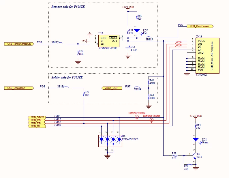

  • Ensure that the 24MHz crystal is properly connected and oscillating. Incorrect crystal connections can cause USB communication failures.
Follow the recommendations in the schematics provided in Nucleo F303 FBL_1-1731928128043.png

As i said before, the current fw is a Vendor Specific device and it's running(at least it's detected by Windows and the PC software), So i don't think there is a problem in the design. I'm looking to change or get better(i don't know for the moment) that USB fw because there is no documentation about, and i'm trying to run examples first. I can't sniff the communication cause the USB is not detected as i said.

I'm back to know if you have any idea why a simple USB example can't work looking the schematics i sent knowing that there is a USB fw working on it that i want to change.
